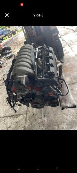

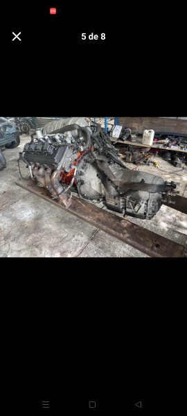

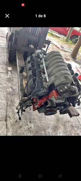

Well, I've come to a decision. I'll just buy the 150,000 mile Hemi 6.1 without the NAG1, which has no PCM and no accelerator pedal, but has a wire harness for $2,500. It's already in Miami, so I don't have to pay shipping. I already bought an '08 Ford 4.6 from this seller, and it seems like a decent engine.

that. it is missing the alternator, accelerator pedal and PCM, these items it does not have.
