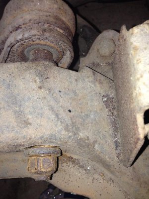

Ok guys need a little help. I am trying to remove the torsion bars from the car. You can see in the photo that the nut is backed off to the point that it is spinning on both sides of the k member. I have the clip from the back of the torsion bar also removed. I do not have a torsion bar tool and that might be the answer to my questions. I have tried to move the torsion bar back using a dead blow lightly with no success. What am I missing here?

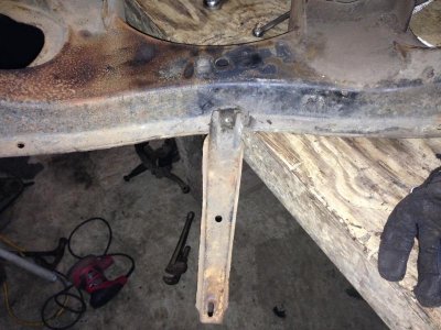

You can see the missing dirt here where I used the rubber mallet. I might need to just man up and knock the crap out of it but didnt want to tear anything up.

Thanks '68 GTX! As far as getting those puppies out, you want to make sure they are fully unloaded. That would include the obvious ones...A) Loosen up the torsion bar adjusting bolts all the way out (very bottom side of the lower control arms) B) Getting vehicle front end completely off the ground. Last would be like you've already accomplished, removing the retaining clips. Next, if the upper control arm and lower arm are still attached to the spindle/drum, you want to remove the upper control arm bumpers. Take a look at your upper control arm...the bumper is about 1" DIA, and is shaped like a bullet. The upper control arm rests on top of it when the car is up in the air. Seen guys remove the torsion bars by different means, but the best way IMO is to buy the tool. Using a vise grip can damage the bars surface.. Severely beating on it can do the same.

You can unbolt the K frame and the bars may come out the front of the trans x member easier than the back. Then you can work them out of the lower arms. That's what I did and lots of WD-40 on everything. After you bead blast everything the bars will go in and out easy either way.

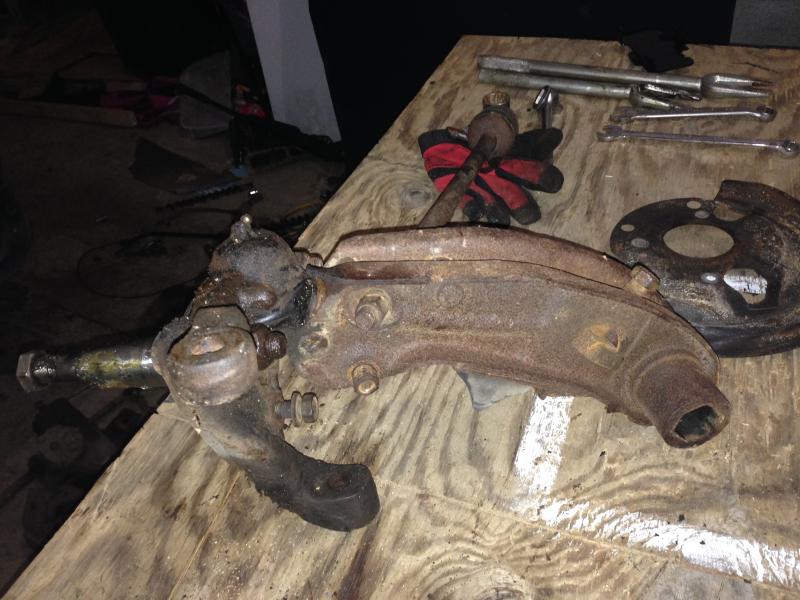

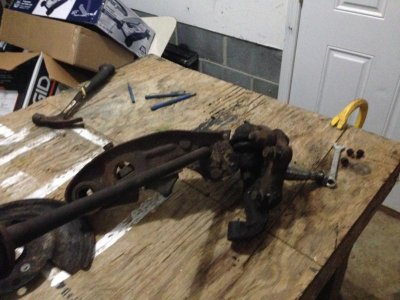

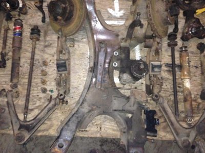

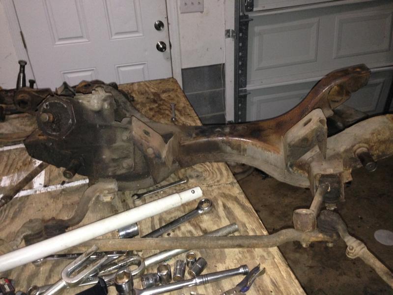

This is what ended up working for me. I think the tool would have worked as well but I will be out of town next weekend and didn't want to wait for the tool to arrive. So I removed all four bolts from the k member and rocked it lightly until the torsion bars moved back. Once they dropped back I pulled the k member forward and both torsion bars came free fairly easily. I finished tearing down my first front end after that was accomplished. Pics coming soon I really had way too much fun getting this torn down. I am about to order the rebuild kit for the front end any you guys would recommend? I was thinking the front end kit from PST.

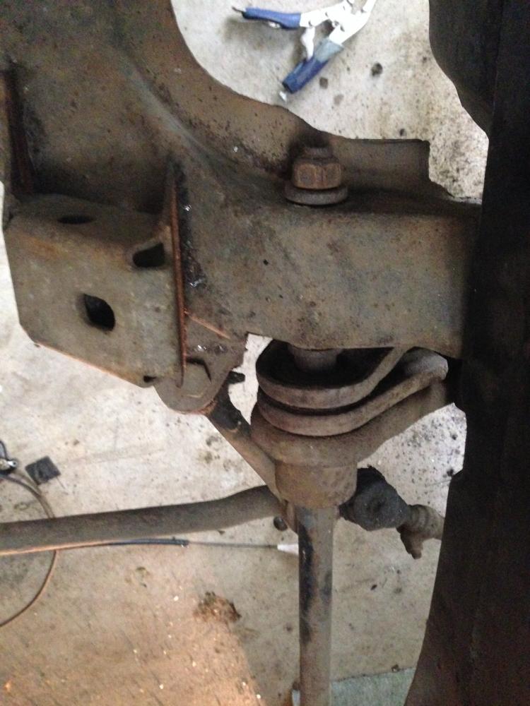

If your budget allows you may want to go with the PST kit or similar, but I went to my local parts store/s and got everything as needed. Quality was good and price was great. Most stuff was Moog I think. Be sure to lube everything up as you tear down, you can ruin some stuff if not, the lube will help you save and reuse a lot of stuff. Not trying to be a critic but that torsion adjuster in the 3rd pic looks very dry. I have seen those fail., and they could fail when your under the car, which would let it fall on you, something I never thought of till I saw it..
