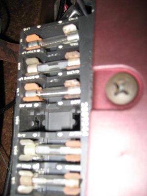

I am putting my 68 gtx back together and am placing a new year one wire harness back in the dash. What I need to know is the fuse box location. This is an air condition car. My 67 Dodge Coronet wagon has the fuse box on a metal tab on the drivers side near the kick panel under the dash . I do not have that tab on my dash of the GTX. Can anyone point me in the right area. The car has been apart for 3 years and shame on me for not taking pics of the area before I tore it down.Thanks. Any help would be great.
Goes on the lower part of the dash, L. lower area of the glove box

Thank you. I tried it this morning and bingo that was the spot. I'm going to be busy today. Thanks again.
