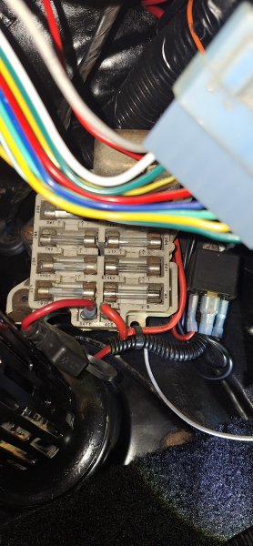

My 74 Charger has a loose fuse box sometimes when I turn the car over it starts but stalls when the key goes back to the Run position I checked everything and then I found that if I pull on my fuse box a little bit it will stay running in the Run position I'm having a hard time getting the fuse box out so I can find out my situation is it clips I don't see any screws what holds that fuse box to the bulkhead firewall side

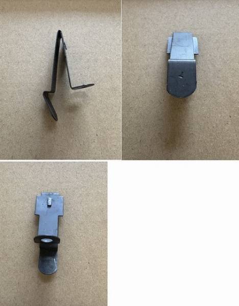

If my 72 is like your 74 then you should have two of these clips (this is just one at different angles).
I took this out of my original bulkhead to put in my reproduction bulkhead as they are not as good as the originals.
I was experiencing the same issue as you.
