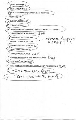

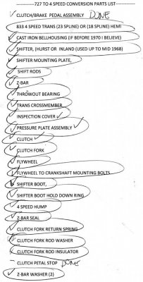

I converted my '68 Charger from an automatic to a 4 speed. Here is a list of parts that are needed, might be helpful.

Thanks guys. That list should do me quite well, thank you for that.
