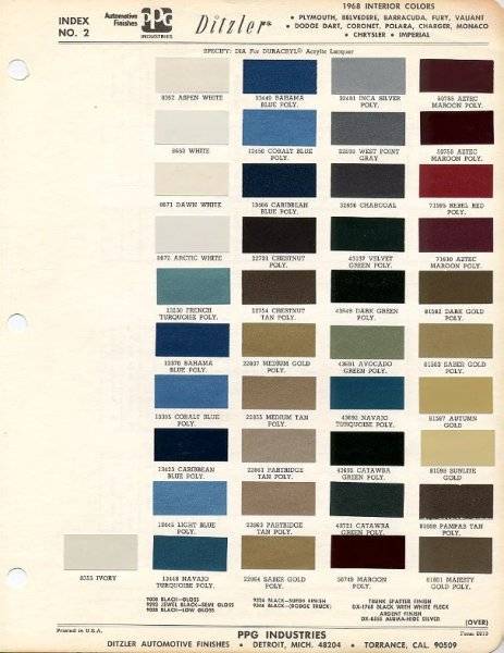

I see a Navajo Turquoise Poly on this chart (two different codes) that look very similar to the Teal color. The problem is that the color chip on this sheet looks close but the stuff I find on the internet doesn't:
Trying to find examples of Cobalt Blue Poly 13395 and Medium Blue Poly 13355 is proving difficult as well.

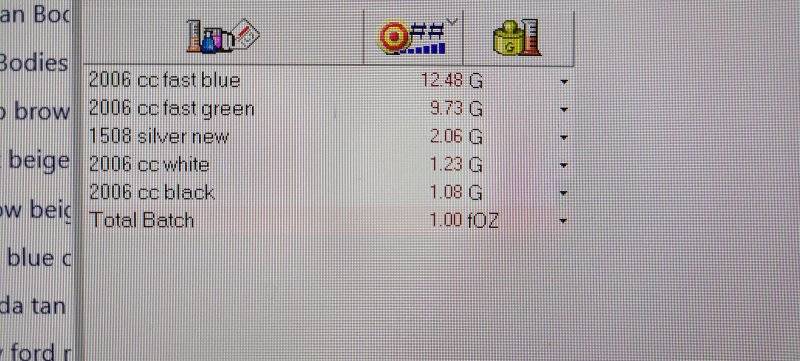

If you look at the label on the quart of SEM dye, you'll see that I had Vinyl Pro out of Marietta Ga. mix it up for me.
I sent them the horn button and they mixed it from a known Mopar formula. The picture of the two glove box doors
are the original clean door next to a dyed door. Dead-on! Here is the SEM formula.

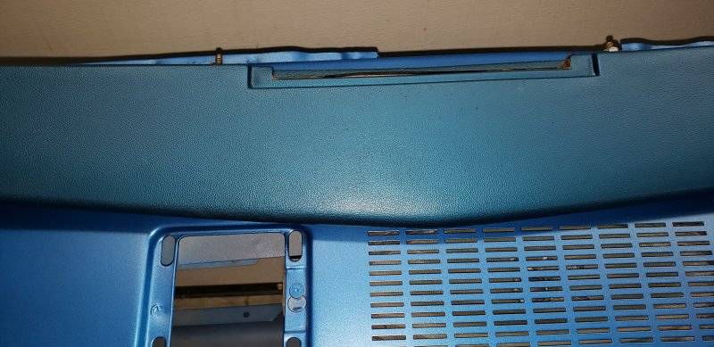

You would be correct Mario! The only thing that I found on my car is the Dash pads and the console are
a Turquoise shade as seen in the pics. Also, the arm rests are turquoise. Go figure!View attachment 1423457View attachment 1423458View attachment 1423459View attachment 1423463View attachment 1423464View attachment 1423465
In the above referenced picture, is the Dash Pad the Teal or the Glove Box and Armrests?
They definitely look like different colors to me but I guess it could be camera angle or lighting?
The Dash pad looks like a match to my original lower dash pads.
Dash pad, lower dash pads, B-pillar moldings, console, and all four arm rest pads are Teal.

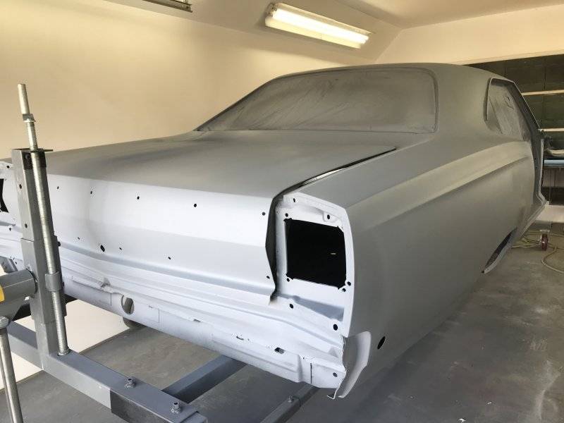

I finally bit the bullet and bought a rotisserie and got the car mounted on it.
I thought all the blast media was out of the car until I turned it on it's side. Then I turned it upside down and got a real shock. All in all, I rotated the car about 5 times, tapping the frame rails and supports with a dead blow hammer, to get all the media out.
Really wondering why I didn't buy one of these years ago?
I did a lot of hammer and dolly work on the quarters as both had been previously banged up.
Tried real hard to use as little body filler as possible and then shot another coat of epoxy on the quarters, cowl, roof and trunk lid. I have some 80 grit scratches showing, but my plan is to shoot another coat of epoxy tomorrow and then when cured block sand it all with 180 grit to see where I'm at.
Hoping to go straight epoxy with this car and I'm so confident, that I ordered a gallon of 2k build primer to have on hand. LOL

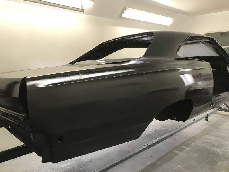

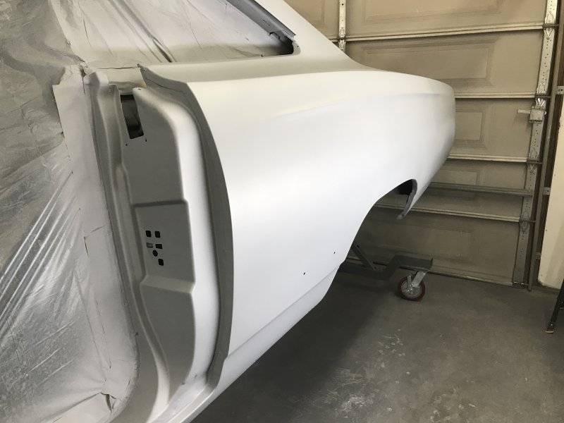

I wasn't happy with the build of the epoxy primer so went ahead and shot two coats of regular 2k build primer.
Tomorrow afternoon I will apply some guide coat and start block sanding.
One thing I didn't elaborate on is please use a primer gun with a BIG tip in it and you will get alot of
material on the car without dry spots, and it will take alot less time!
I have an Air Gunsa AZ3 HTE2 which has a 2.0 tip on it. Hoses the stuff on pretty good.
