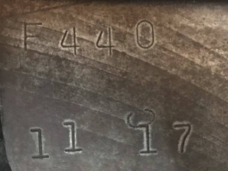

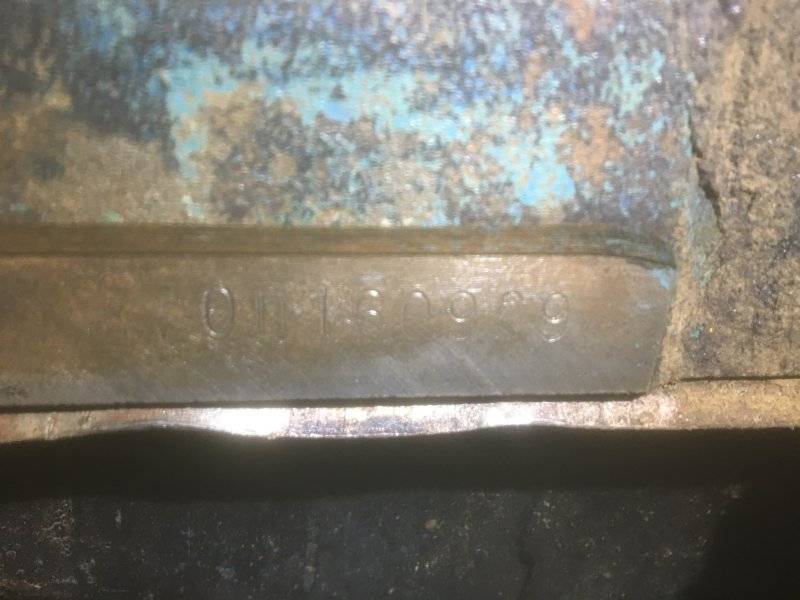

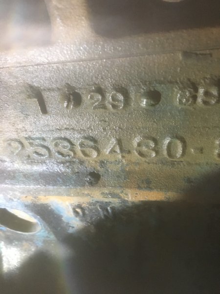

Looking more closely at the engine that came with the car.
It's a 1970 block with F440 stamped on the pad. Here's some pic of the numbers:
The guy said it was running when they pulled it but I am debating whether it's worth my time.
I would prefer to get a correct D440 HP block. Any thoughts?
After all the work you have done, a D block would be cool, but IMHO, not worth the time and $$$.
Thanks. I think I'll wait until I disassemble the motor and check it out closely before I decide. Who knows, since it's not the original motor this one may have been machined and built especially for it?

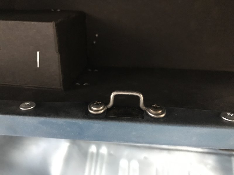

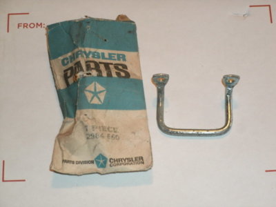

Having a bit of trouble getting a glove box lock to work with this wire catch.
I am on my third lock thinking they were defective because they kept getting stuck in the open position. Now I am wondering if it's this catch that is causing all the issues?
Tried moving it forward and backward to see if that would make a difference but it doesn't. I see now why they moved to the spring loaded style catches.
Does anybody have experience with this style catch and would be willing to shed some light on why I'm having this issue?

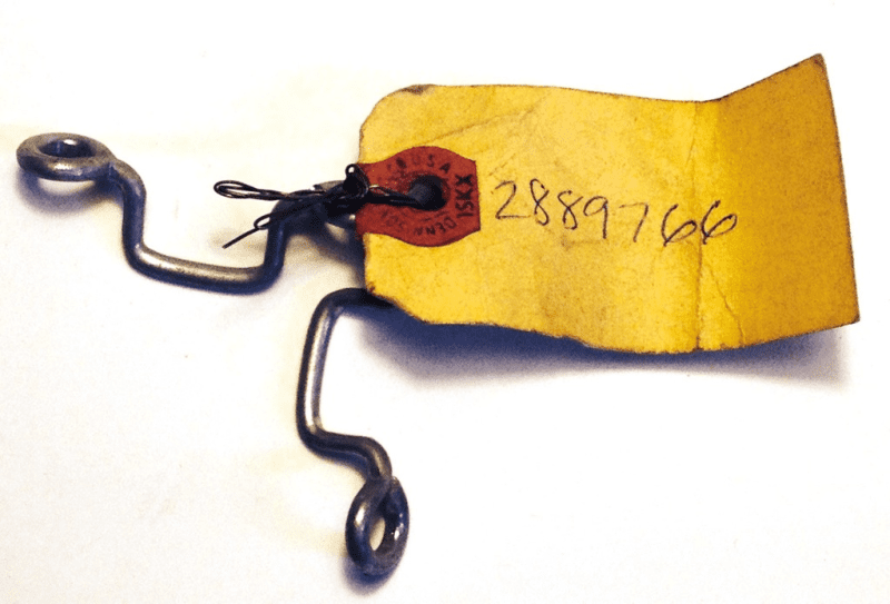

Those things didn't work well when new... Also there are a few variations of the bent wire catch, Rally, non-rally I think there are a few A body & C body versions too... in 70 they changed the door to hinge from the bottom....
In fact yours looks wrong to me.... I can't say this one is right but it was listed as 68-69 B body... Well the first photo wouldn't load... And this one is for Rally Dash... We need someone to post a photo of the Non-Rally part...
If it helps, this is the glove box catch from my ‘69RR non-rally dash…….
I have found the catch sets to high. Get a coat hanger and build one a little shorter then modify the one you have.

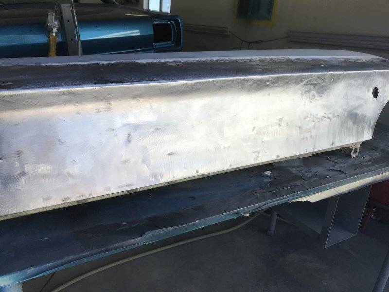

Started stripping the right fender today and discovered some holes that had the "cave and pave" filler treatment.
I knew this was a replacement fender because it had a different base color under the gray primer.

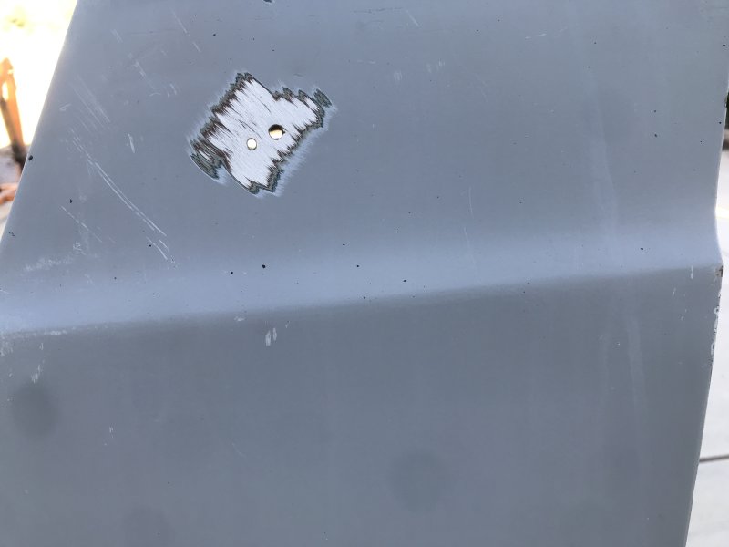

There must have been an emblem on the front side:

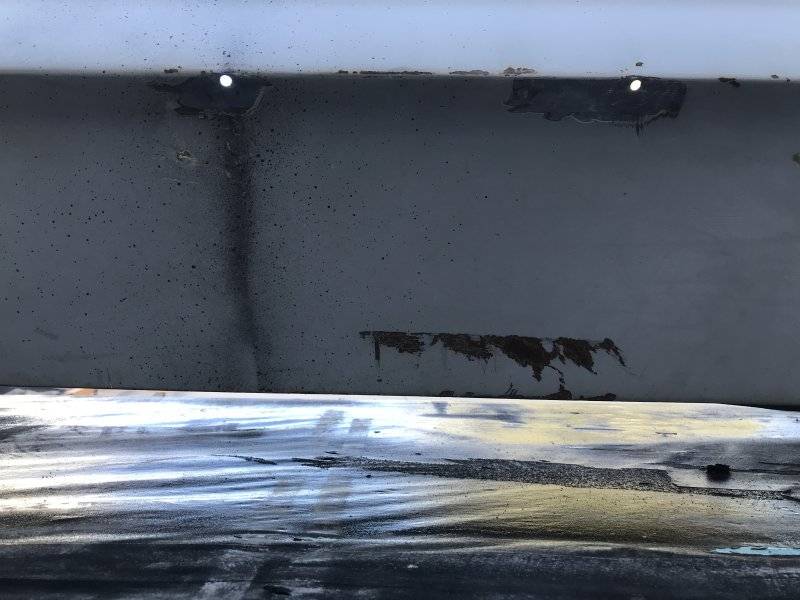

Then a series of 1/4" holes along the top edge:
I plan to weld these shut and will have to drill a hole for the front rocker panel molding clip.

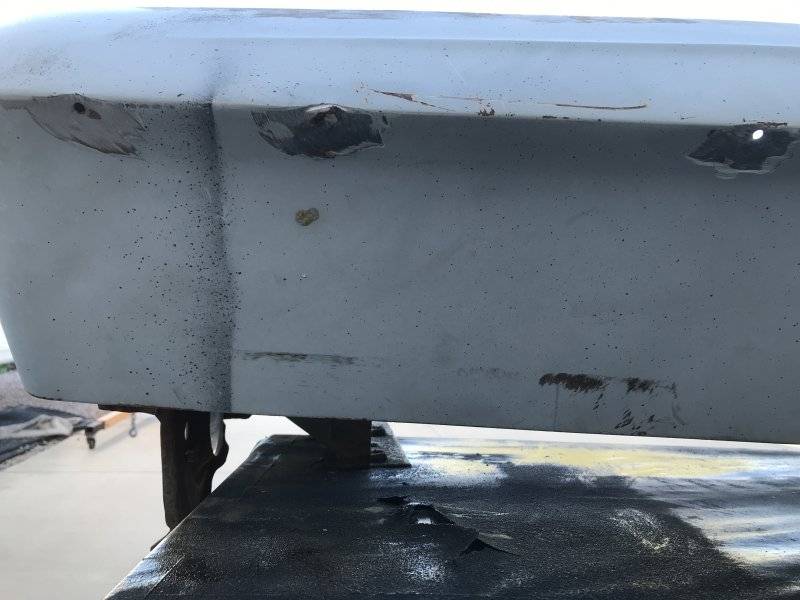

Holes welded up.
For the most part it came out pretty good. They had cracked the metal in a couple of places on the body line when they hammered the holes down but got it back in pretty good shape.

I had to use a stud puller in a couple of areas, as the filler was deep. Holes along the top:
