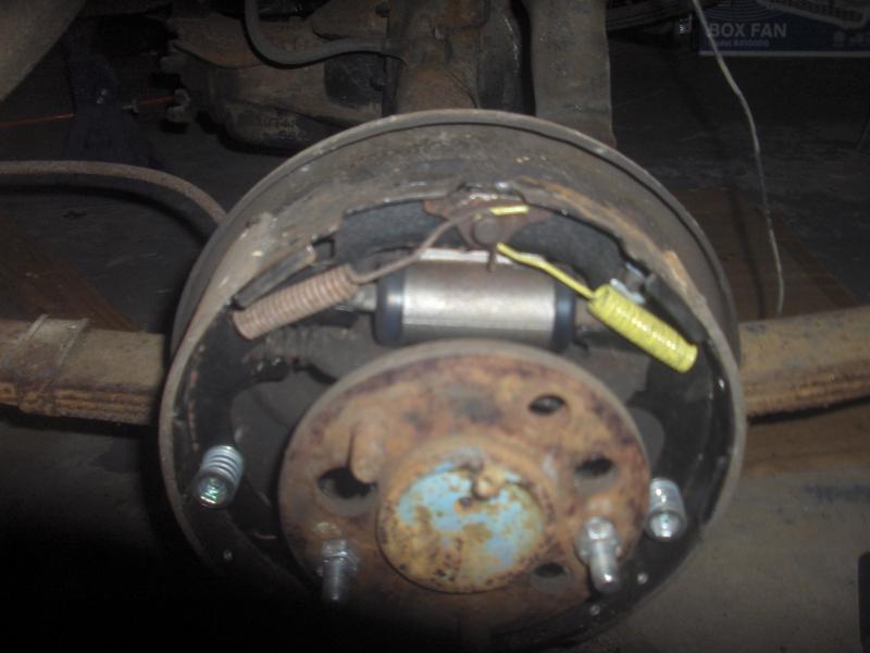

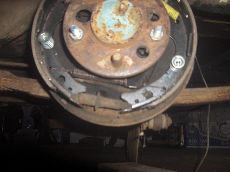

Hi need a photo of what the 68 Roadrunner brake shoes look like once you take the drum off, looks like I am missing parts. Thanks Phil

The adjuster is kinda cut off at the bottom . This is a front 1969 RR
Hi Thanks for the photo, so does the rear have the adjuster cable? My rear looked like your front, I havent looked at the front yet. Phil
So do we need the adjuster cable or no do you know? Its a pain to put on and not sure what spring holds it on, I have 11 im brakes. thanks Phil
11 inch brakes did not have the cable adjuster if I remember....you had to adjust those periodically by hand
