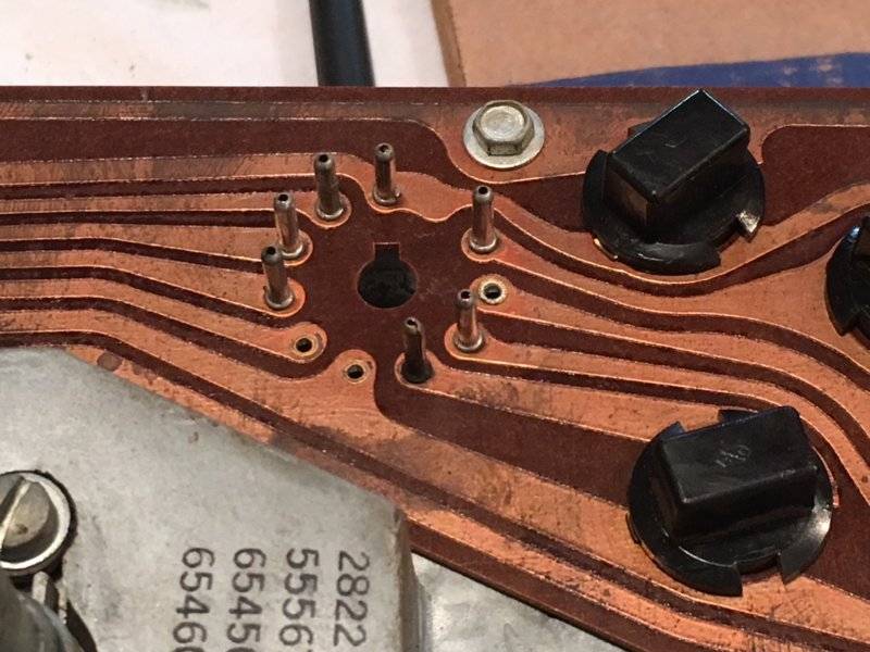

Anyone ever run into this?
My harness pulled four pins out of my gauge cluster circuit board.
Has anyone ever soldered these back on?
Not sure where to source a replacement board?
THANKS!!

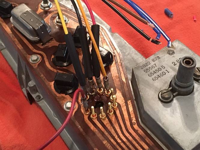

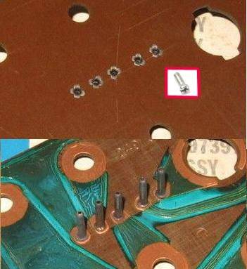

I have replaced missing/broken pins by using eyeglass screws to secure the pins to the board. The pins themselves are hollow so inserting screws from the back pulls the pins tight to the board. It's important to use the correct size screw so as not to spread the pin too much. Eyeglass kits with assorted screws are available at any drug store. Once tightened you can also solder if needed.

I inserted a Brad nail through the back and cleaned and fluxed everything well. A good solder iron on the top of the pin and apply the solder at the bottom where the break occurred. When it gets warm enough the solder will wick up the pin.
So, after assembling entire dash with brass screws in place of the old pins. I found the 'new' pins were not contacting the original plug very well- flickering lights.

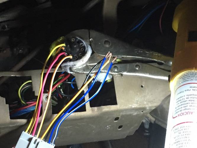

I decided to solder a new plugin harness between the original.
Rather than removing the screws I used them to solder wires directly to them. Then on the Female side I soldered wires to the original plug. Used heatsink on all connections, now after installation lights work 100%.
Not the cleanest solution, but simple, cheap and I now have a reliable plug for disassembly.
