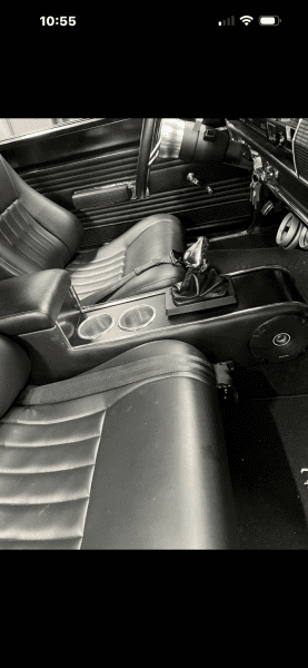

Here's those Teas seats in Rick's Coronet. He made the console himself. The Teas are over $2000 a pair. That seems like quite a lot but rebuilding stock seats isn't cheap either. Frames and bases are spendy if you want to change designs. Foam kits and upholstery will run you over $1000. I think Rick has a tilt wheel too. Ididit if I remember right.

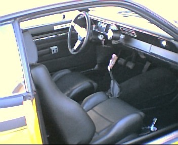

When I had my Duster we installed Corbeau seats. I really liked 'um.
Should be good in a B too.

Some people object to a look that is so far from stock but these Corbeaus are a good looking seat that will hold you in place better than any stock seat. The seat-back is adjustable for angle and rear seat access. They do have mounting adapters but the early B body may not be on the list for what is available. You can cut and weld though so this is all within your skill level.
