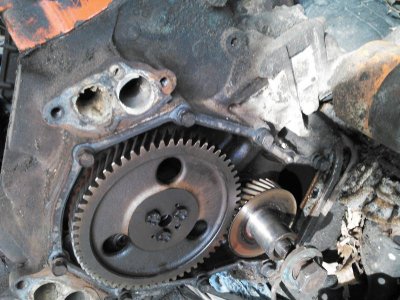

I have been slowly taking apart my 413, I have 906 heads, I am going to get different pistons, different intake and camshaft. I took the timing cover off yesterday, I have a timing gear not a chain, I want to put a different cam in but I want to keep the timing gears. There is no problem doing this? Is there?
Now I might be wrong here, but I think you have a marine motor. If I'm correct here, that cam is a standard rotation cam, it's the CRANK that is reverse rotation. They used a 2 gear timing setup to get the crank to rotate in the opposite direction for multi-engine marine set ups.
Did you have the same gears in your motor?
