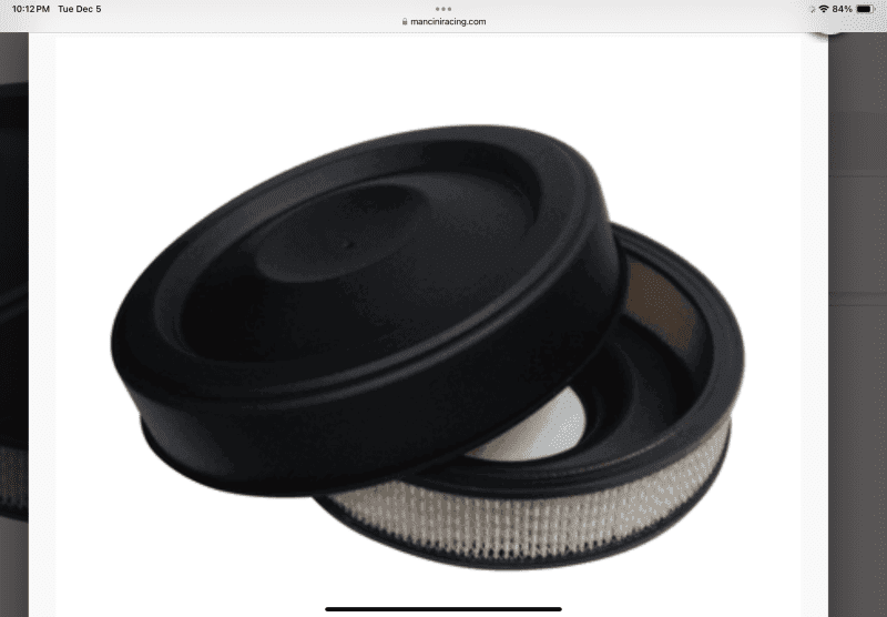

He’s asking about the air cleaner lid. The high performance air cleaner lid was black wrinkled semi-gloss. The low performance air cleaner would be black semi-gloss. The picture below is of the high performance air cleaner.
