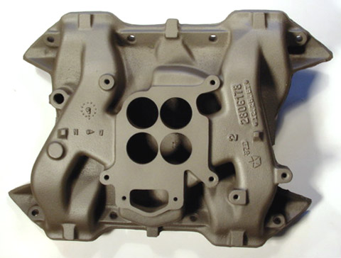

Just an fyi as far as stock intakes.
The 2806178 intake was used on all 440 4 barrel engines from 1967 through 1969, on both standard and high performance models. Because of the years and engine this intake was used on, it is considered one of the best "muscle car" intakes.

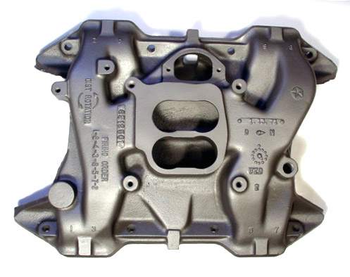

The 3512501 intake was used on 4 barrel 440's in 1971 only. 1971 was one of the last years before "smog" equipment began to find it's way into intake manifold design, and this particular casting is generally considered to be the best flowing stock intake available. Visually, (port shape & size, etc) this intake has the most similarities with aftermarket aluminum dual plane intakes such as Edelbrock's performer
