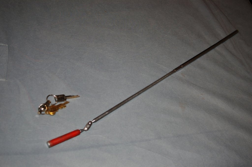

As far as I know the special additive was added to the break in oil for the cam and proper break in done. How about the tools advertised to remove the lifter do they work ok?:
Through the years I've only had to perform this procedure twice and both times I used a fairly strong parts pick up type magnet with an extendable arm. I didn't need a specialized tool for the job so I can't comment on that. But here is a photo of the magnet that I use if it helps.

I did get the failed lifter out - but the center lifters will not come out throught the intake.
Maybe they could be dragged to the opening that is big enough. I didn't have the nerve for that. After all they were new lifters.
If it were me, I would invest in an intake bathtub and pull it. You should visually inspect the cam too.
