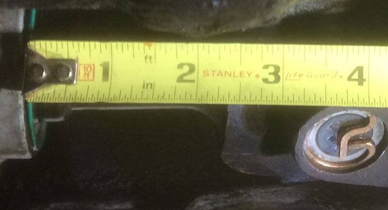

1969 GTX 440 4 speed. i have been getting a vibration that definitely feels like it is in the drive line. From 45 and up getting so bad that i dont want to dive it over 55. at low speeds it feels as though i had a bent drive shaft. i jacked up the car to check u joints and such, well turning the wheels I hearing a thump thump thump sound . traced it to the trans out put shaft. since this is my first 4 speed mopar the question is. how much play is to much? and do you think it could be the reason for vibrations? i have been looking at the service manual and have not been able to find a tolerance for how much play is allowed. does anyone know the tolerance for the out put shaft?

checked the ujoints and the yoke depth. u joints look new and no slop , yoke depth is very similar to the picture.
