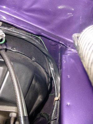

If he say`s it`s a 4 speed but not sure, I would start by looking for the firewall reinforcement bracket, by the master cylinder, that goes through the firewall & is spot welded in place. This is one of the most common over looked items, when switching from auto to 4 speed. Very difficult to put this in properly to look factory.
