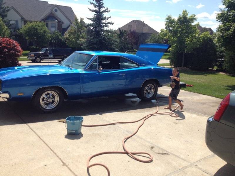

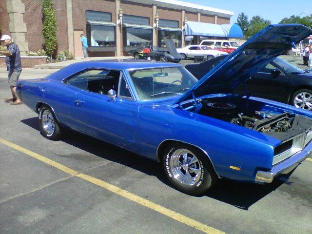

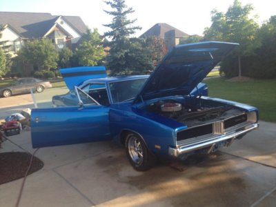

Thank you demonic and Jerry Hall. Also, sorry for slacking with the pics guys
PS before I get massacred, I know R/T’s didn’t come with 383’s...previous owners badged it that way...maybe one day will find a 440 or god willing a 426 to make it a true replica lol
