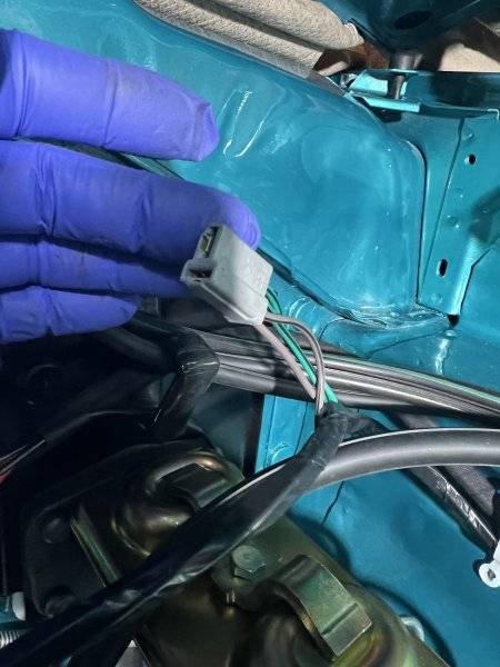

Just installed my new headlight harness. There is this female plug that is on the wiring harness that is near the master cylinder. Anyone know where connects to? Anyone can share a photos of theirs please.

I checked my old photos and that was never connected. dont know if it was for an option or not. My high beams worked without that connected

Only thing in that area would be the high beam switch...?

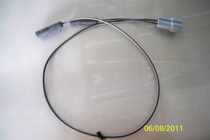

Here’s a picture of the wiring that plugs into that for the turn signal indicators on the hood. Yours might have the turn signal delete same with @Triplegreen500
