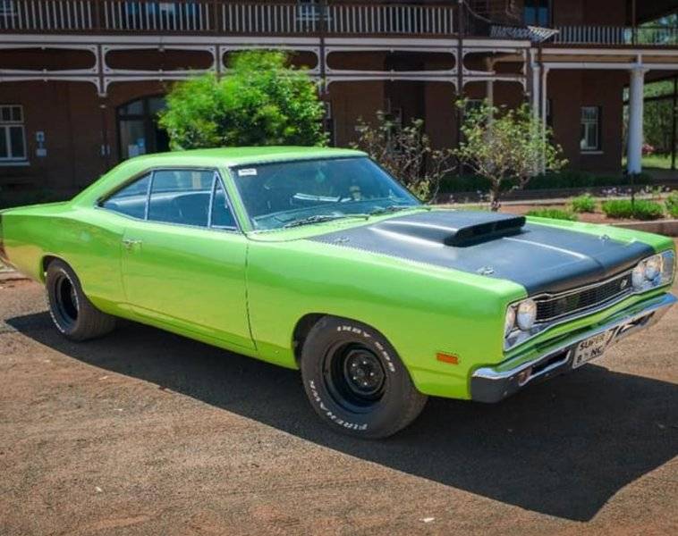

Good Day from South Africa.
I recently bought what was according to the Vin a 1969 Coronet 500 A/t with 318. Once of the previous owners went thru a lot of trouble to turn it into a Super Bee Tribute/ clone. Although this is my first muscle car , I can tell the current 383 , Holly performance carb , and Edelbrock performer 383 intake, combo is not all that it could be - performance wise.
Where does one start - without taking engine out for better performance ?

Also you have wide steel wheels that look like 8" wide, they weight 30-32 lbs each, plus those big tires. They both slow the car down in drag racing comparisons to liteweight aluminum wheels.
