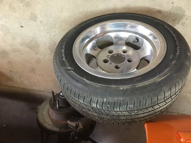

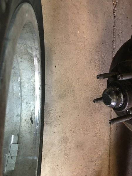

The largest you can fit is a 10.95 rotor and depending on the wheel used it is still a tight fit. Are you using factory drum spindle's? I lucked out and found a complete setup with disc spindles of a 73 B-wagon for my 68. I just upgraded to 11.75 rotors from Dr Diff so I have the pin style 10.95 caliper brackets and rotors. PM if interested. More than one way to skin a cat on your issue. This is off my Duster with some older 14" US Indy Mags. You can see the scrape marks where the wheel is not concentric to the hub but relying on the shanked lugs to center it. Yes it is that close. Had to get Custom rings made. This is so I can run 14s to clear the Hooker fender well headers.
