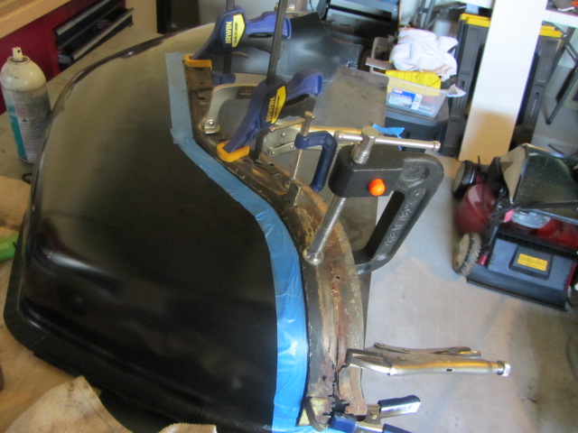

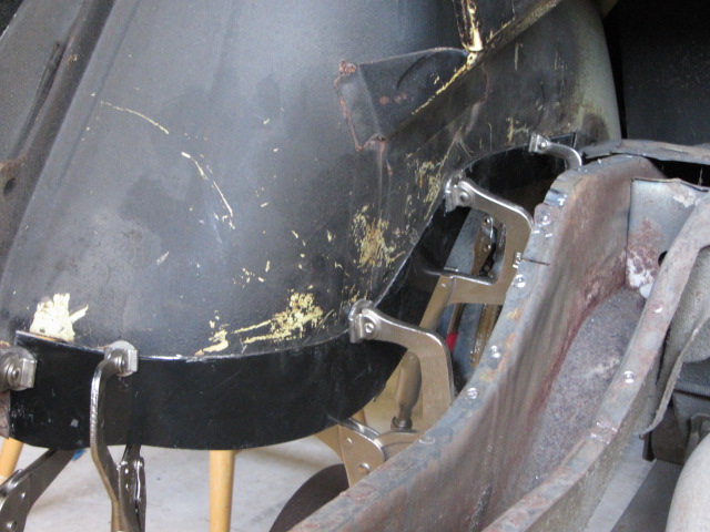

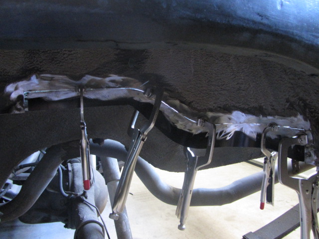

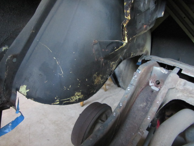

Got a little work in today because I am oncall for work and that means I am stuck to the house for a week. Started working on the LH inner wheel well rust. I know some of you guys can fab this stuff up no problem, but this was my first stab at it. So I cheated and bought the inner wheel wells from Jeff at 521 so I could cut my patches out of them. I still need to tighten up the gaps a bit and then get to welding it in.
Craig
