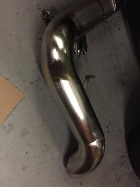

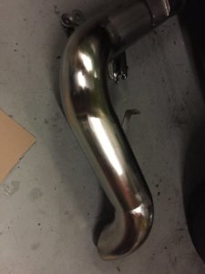

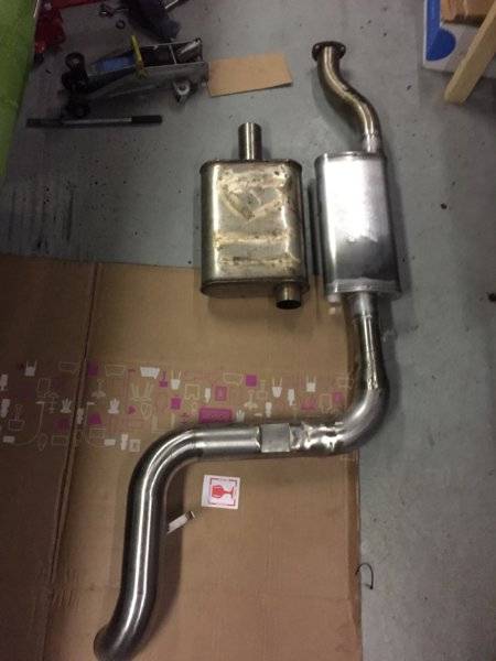

Got some new mufflers for the exhaust, finished one side and am busy polishing the side pipe before putting it back.
Forget to shoot a picture, will do later on.

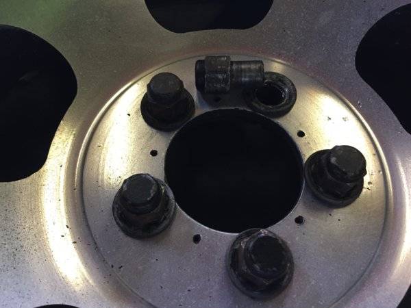

I broke all 5 wheel studs on the rear left wheel when i wanted to remove it to check the rim specs...never expected to be L/H threads :BangHead:
Should have stopped after breaking one, but strange enough due to the nut design (with the long nose that "centers" the wheel) they stayed inside the rim and only realised what happened after the 5th stud snapped (i thought snapped loose) the complete wheel was loose and just standing there :wtf:
Anyway, lessons learned and i got some other bolts lucky enough to fix it for now.

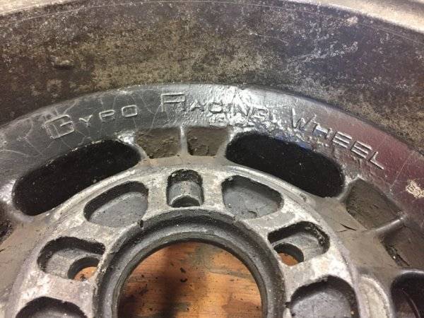

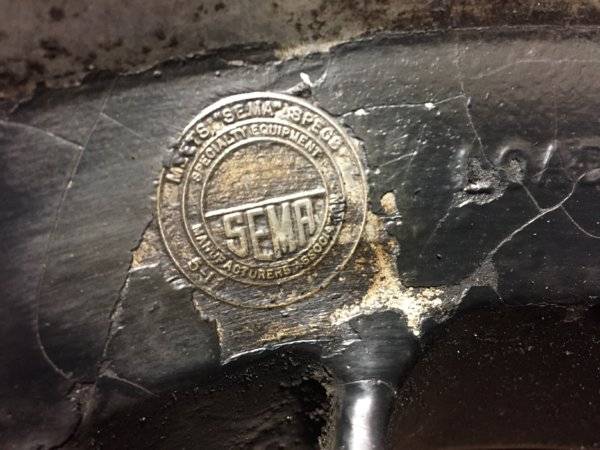

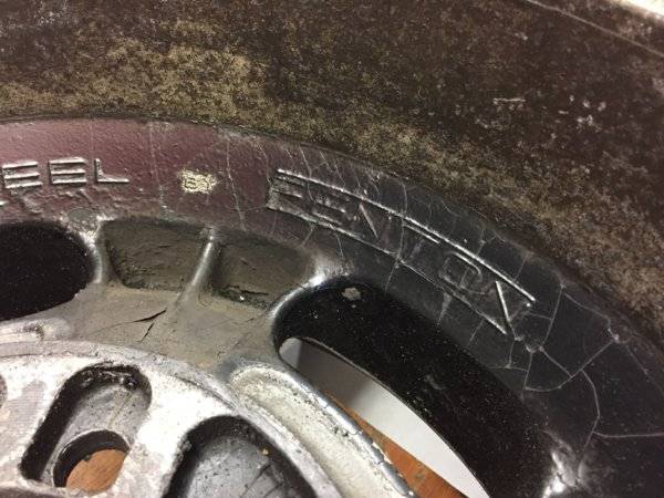

Some pics, my old wheels are Gyro Racing Wheels by Fenton, they also had a SEMA Specs stamp...no idea what this is.

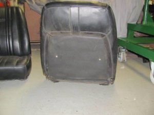

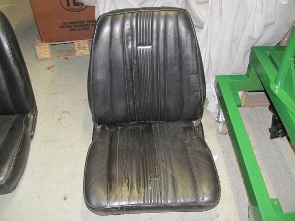

Also some pics of the exhaust in progress, and the "new" seats.
They are from a 4 door car, but the shop added the brackets etc. to make em fit for a hardtop.
To refurbish the rear bench i will order a upholstery kit and new cover as well, assuming the rear bench frame are all the same right for '69 -'70 models?

After i got the exhausts reinstalled it was time for a test drive :) my god that sounds good!
When you floor it it gets this aggressive raspy sounds, at cruise it is a heavy rumble.

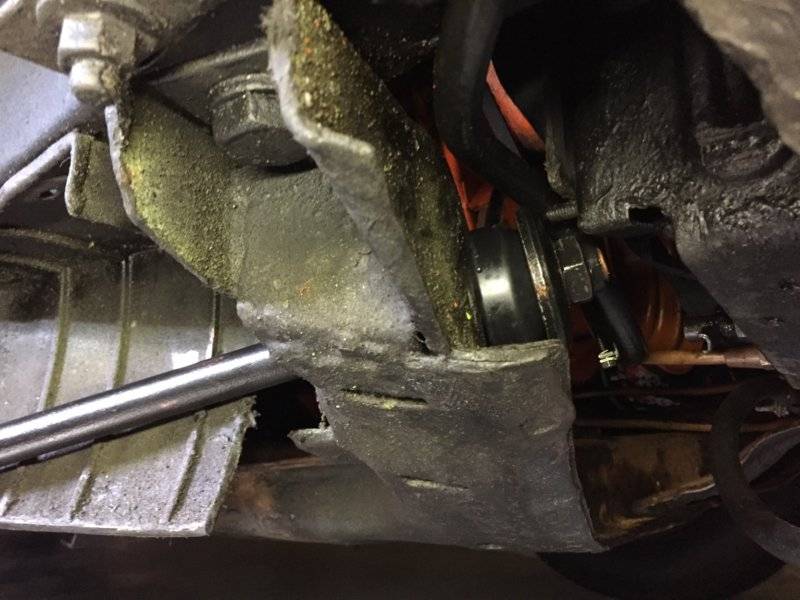

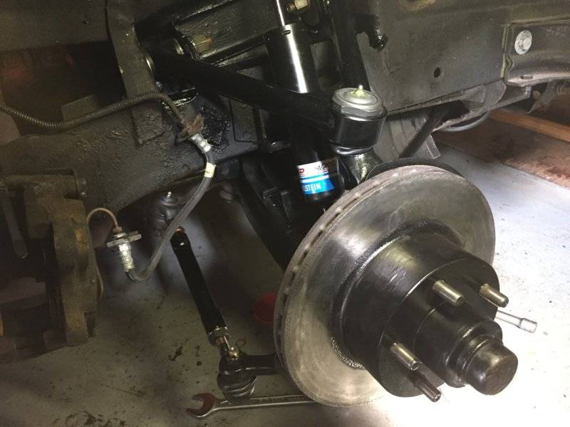

Noticed the steering became a bit sloppy or something and when i came home i just checked the front wheels, when looking from the front the passenger side wheel was not sitting straight anymore. (wheel standing inwards on top..camber? correct me if i am wrong)

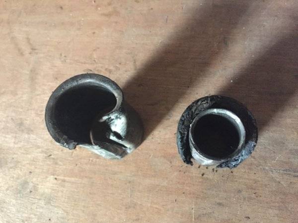

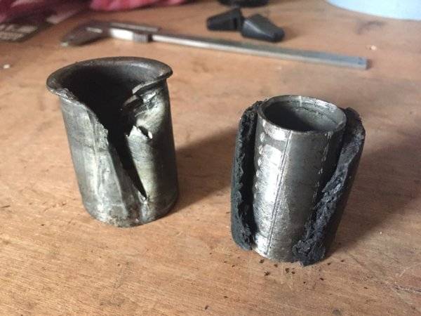

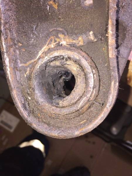

Also noticed the adjustment arm of the torsion bar has been touching the frame, which can only be caused by excessive play on the LCA bushing.
After removing it was quite obvious that it's worn :)
Did notice as well that the upper and lower ball joints are worn as well...very loose and sloppy.

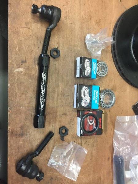

So i had to bite the bullet and ordered the whole lot on new suspension components to replace everything.
I will stick to rubber bushings for the LCA, reinforcement plate for LCA, PST G-Max tubular upper control arms, Bilstein shocks all around, tie rods and sleeves and Poly bushings for strut rods and rear leaf shackles.
Also ordered new wheel bearings for the front, new brake pads and new XHD leaf springs and a 1-18" front torsion bar.

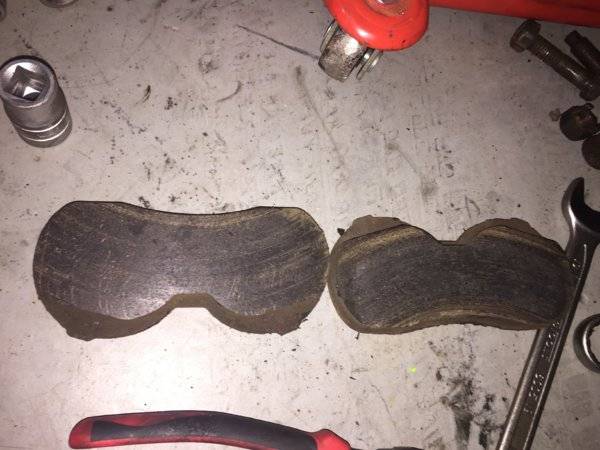

The disc brake i found in a very good condition actually with no sigs of a lot of wear so will see if i can get them resurfaced for the sake of it.

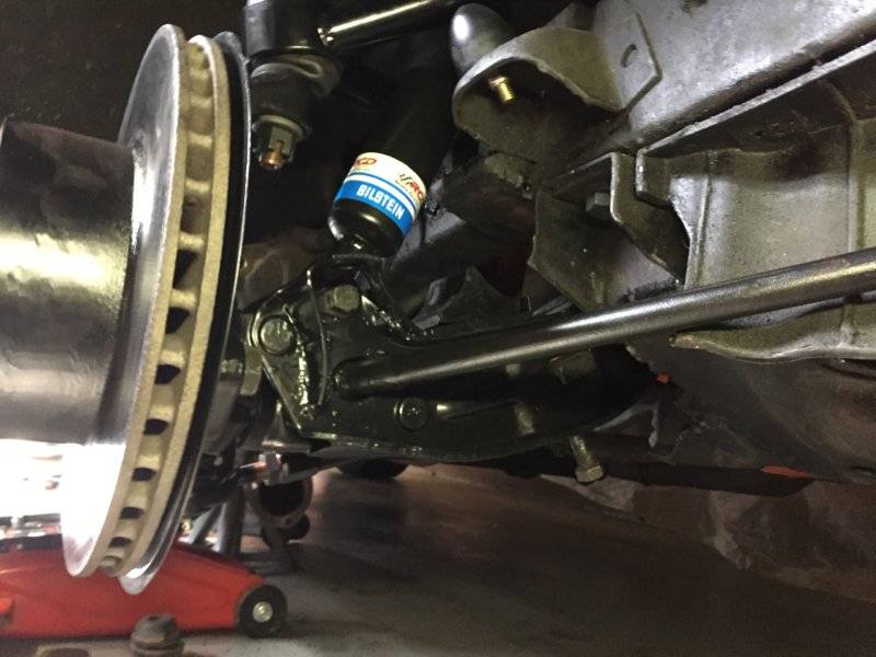

Got a couple of things done while waiting on parts.
I did receive the ordered items from PST. (Upper control arms, Bilstein shocks and schackles & bushings for the rear leaf springs)
Still waiting on other parts i ordered from Germany, hopefully i will receive them this week before going back to work.

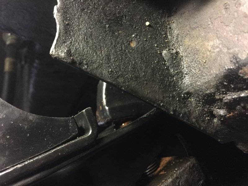

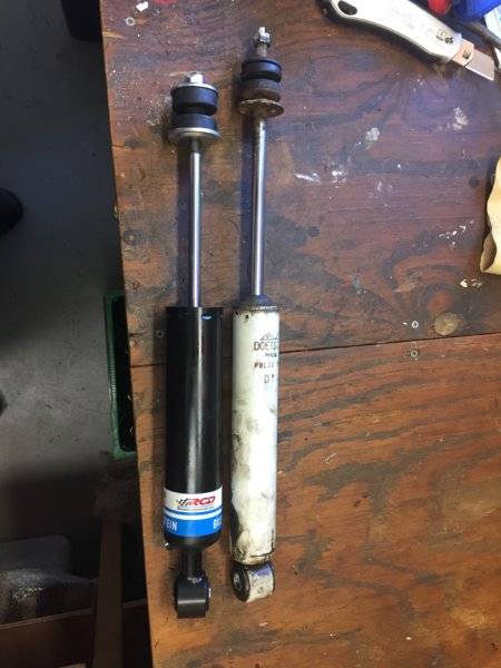

I noticed the new Bilstein shock is shorter then the one that came off the car, i hope this is not lowering the car.
I double checked on PST their website but it does not mention that it lowers the car.
Old shock is a goner....absolutely no power left and i can hear/feel bubles and fluid passing in there.

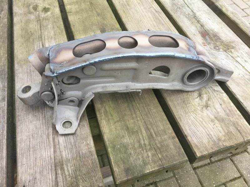

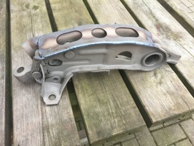

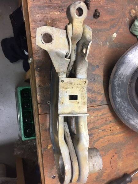

I've cleaned and blasted the lower control arm, unfortunately my small hand held blaster did not last long.
Next week i will go and get a new (bigger) air compressor and a proper blasting cabinet, gets the job done so much better.

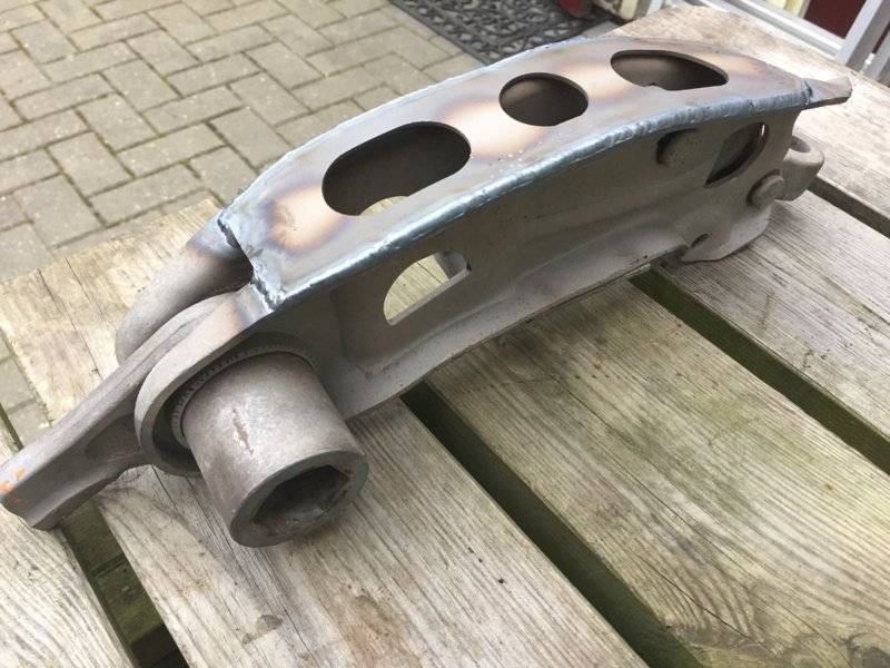

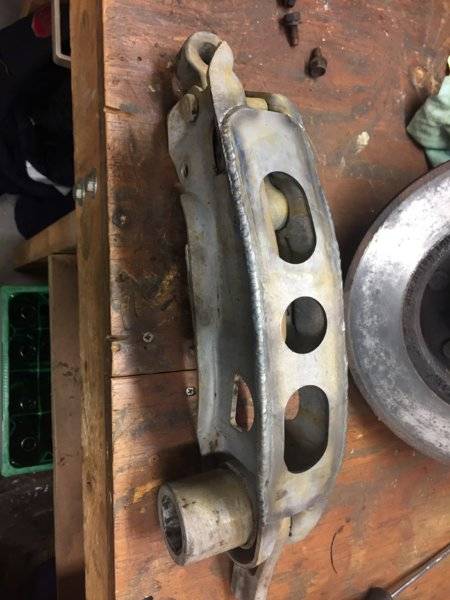

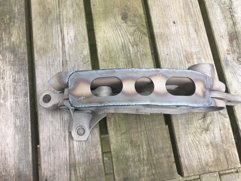

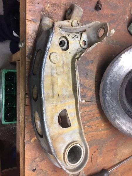

I've welded on the reinforcement bracket on the Lower Control Arm with my TIG welder.

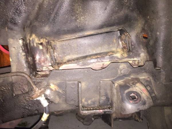

Cleaned up the area to receive the new upper control arm, absolutely no rust to be found here which is a good thing.
The car is covered with a greasy cote that probably is the reason for the car to be still rust free.

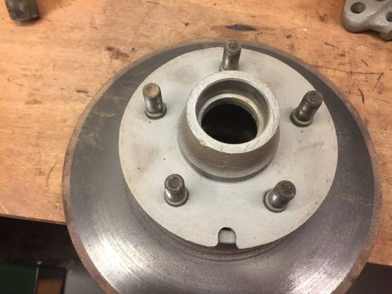

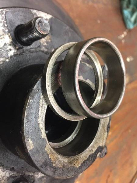

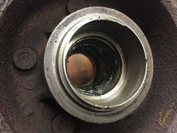

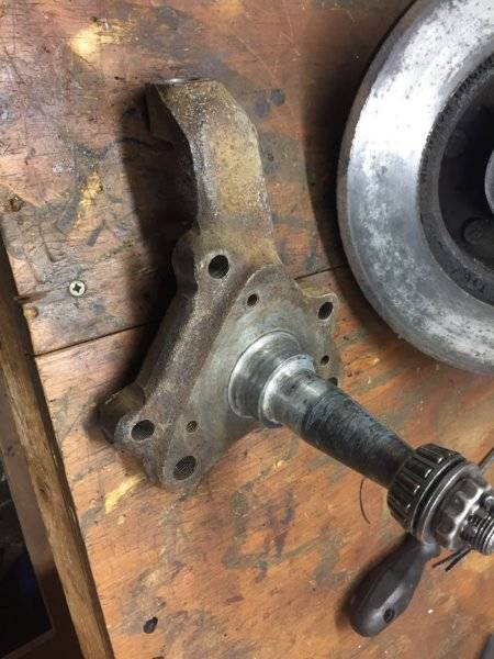

I found a spacer ring under the outer wheel bearing, not sure if this should be there but guessing not.
Once i will receive the new bearings i will see if there are any size differences.

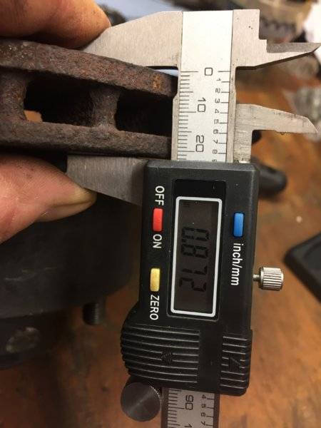

Min rotor thickness is 0.84", measured 0.87" so will reuse the rotors.

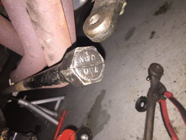

On the end of the torsion bar it's stamped 780 - UBV, no idea what this means.
The rust seen on the LCA is because i already treated it with POR15 metal prep, once completely dry i will coat them with POR15.
IMG_9137.jpg IMG_9148.jpg IMG_9149.jpg IMG_9150.jpg IMG_9152.jpg IMG_9155.jpg IMG_9159.jpg IMG_9145.jpg IMG_9146.jpg IMG_9161.jpg

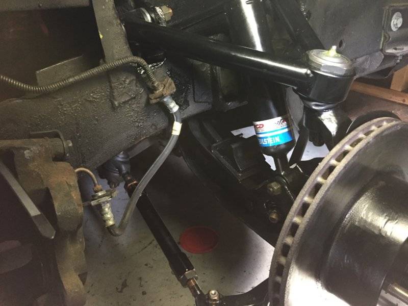

After waiting for some time finally received all goodies needed to finish off the front suspension.
Maybe some have seen my other thread regarding wheel alignment issues, but after looking at the whole picture realising the other side still being in the f*ucked up condition it is not worth the time and effort to get it straight.
Better get the other side done and then look at the alignment again.

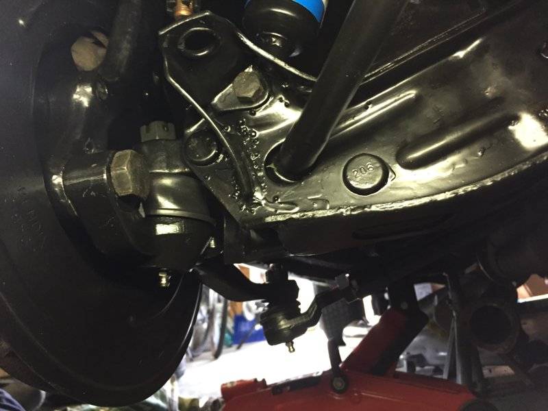

All in all pretty pleased with all items blasted and painted, and it feels very firm and solid.
Pushing on the front end against the suspension the difference was obvious as the rebuild side gave a lot more resistance compared to the other side.

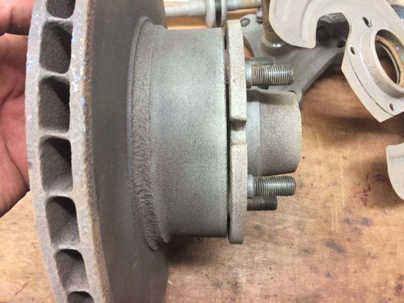

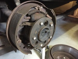

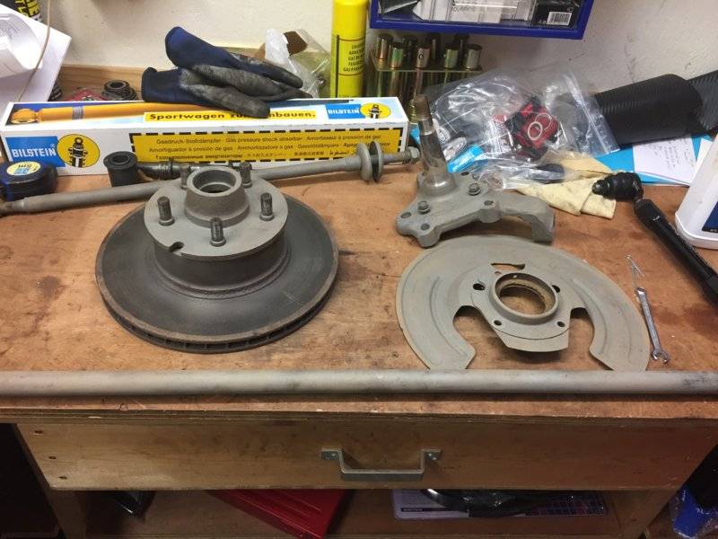

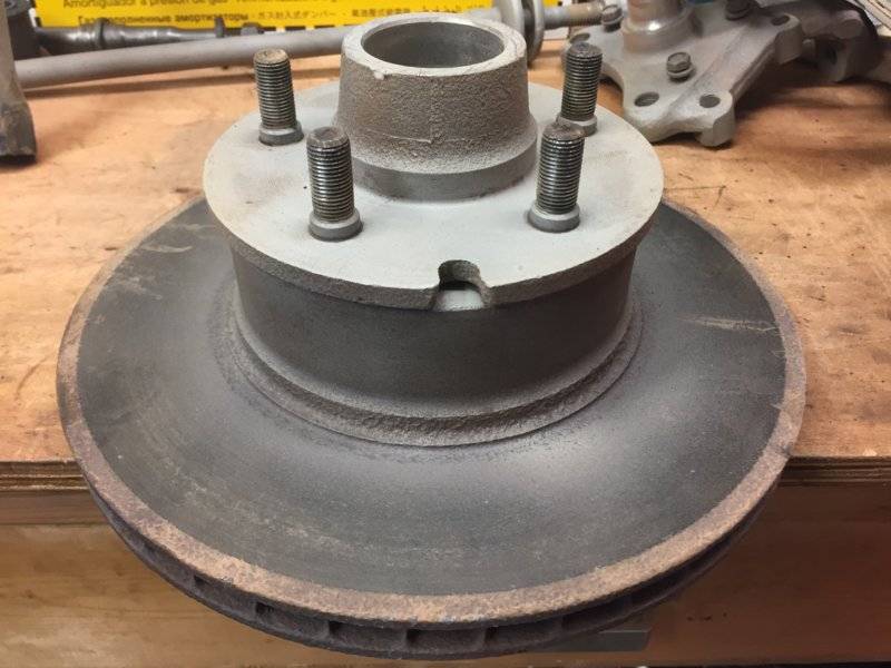

Another thing i noticed, the passenger side disc brake is a not original type, which explains the spacer ring installed behind the outer wheel bearing.
The driver side is a original 2 piece disc brake. (only noticed this being original from the manual btw)
Brakes i am still thinking what to do with it in the future, either find new discs and rebuild the calipers or go for a upgrade kit.

The driver side is copy/paste as before.
All items removed, cleaned and blasted in my blasting cabinet.
Welded the stiffening plate for the LCA and after some cleaning it will be ready for some coats of POR15.
Note: Look at the difference between the disc brakes. The one i just blasted should be original style.

For some reason both LCA bushings (OEM style rubber) did not lock onto the pivot shaft.
I did had to press the pivot shaft in but after found they were still "loose".
Hole and pin are perfect fit but not locked, is that a problem?
