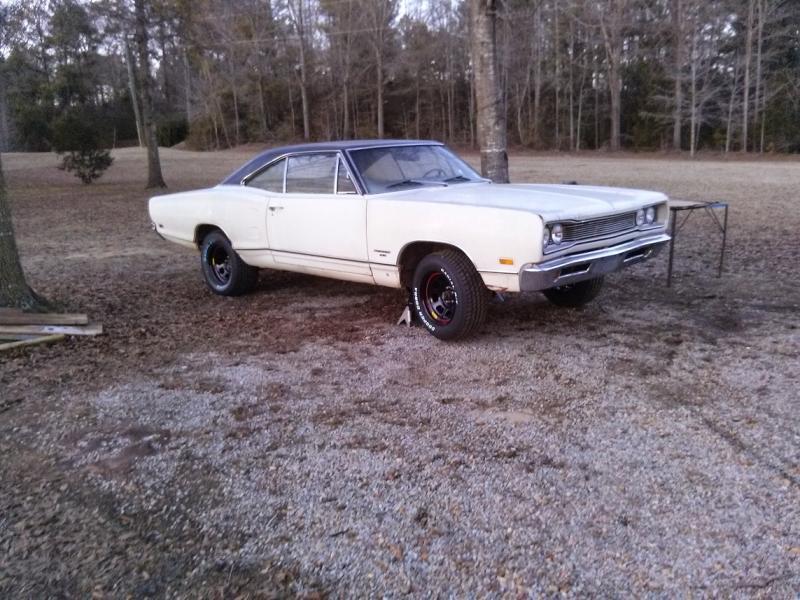

Well I posted about a week ago on a 1969 Coronet 440 I was looking at. I ended up making a trade and am pretty happy with the car. I have always been a fan of Chrysler products and this will be my first Dodge project car.

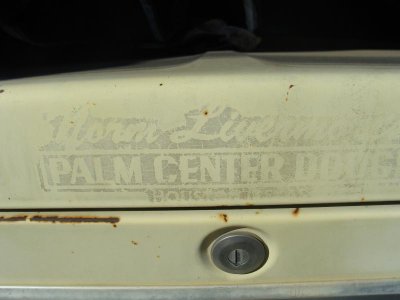

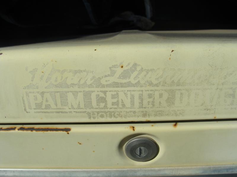

Looks like a real nice car. I love looking at the old dealer stickers and emblems. Mine still had it's original on it as well. Mine is getting hard to read though.

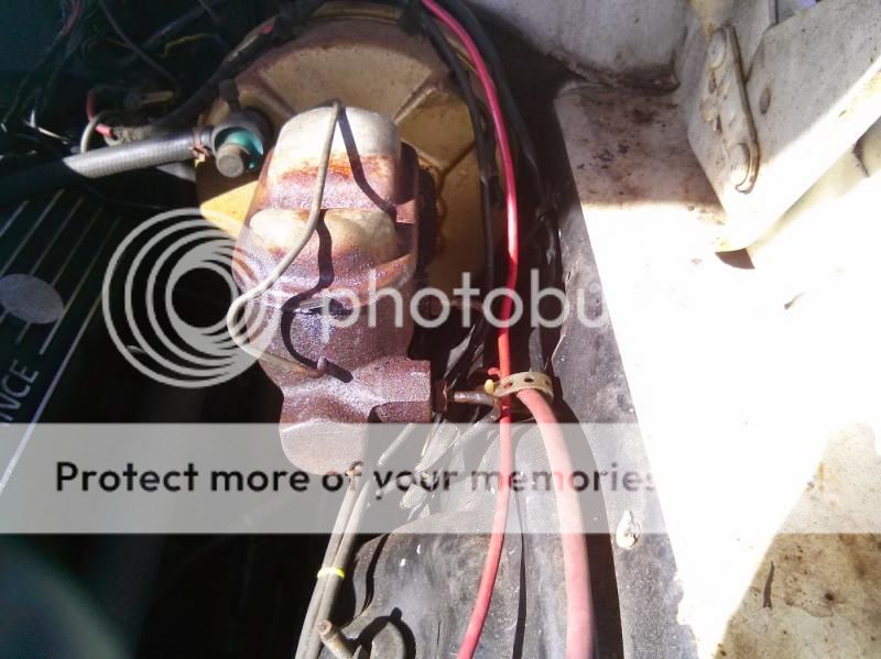

I am going to need to replace my Master Cylinder it is in rough shape inside. Is there a way to determine the correct Master Cylinder? I could not find any marking on it. I am also not certain if this is the correct booster. The car has Disc on front and Drum on Rear.

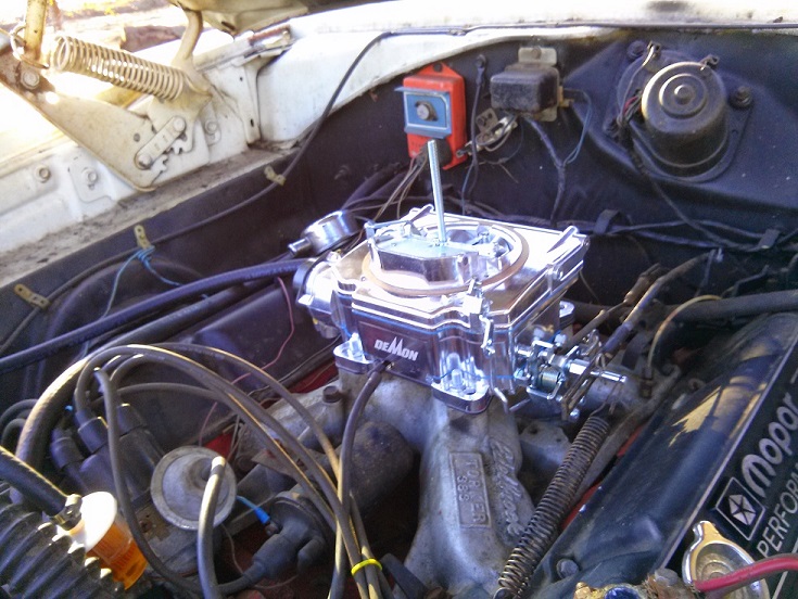

I swapped the carb over to a 625 Demon but waiting on the Chrysler kick-down to come in. Neat looking carb fired right up was really surprised. Looking forward to getting it on the road.

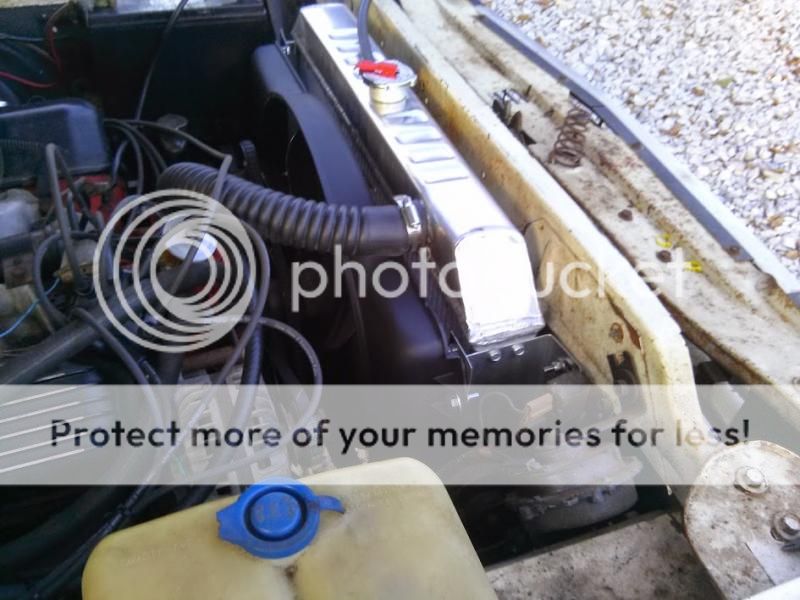

Had a decently productive couple of days. Was able to replace the master brake cylinder, distributor cap, plug wires, thermostat, water pump, radiator, fan shroud, and hoses.
The radiator and fan shroud took alot more fabrication than I was hoping to do. I had to build another mounting bracket out of aluminum to get it to fit properly.
After looking at this pic i really need to wash the engine bay out.
