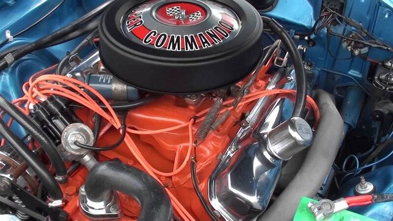

Does anyone know if these cars had a carb spacer with a Super Commando air cleaner?
I've got an air grabber air clearner on there now and I want to switch back to a Super Commando style (dantesparts DMPS-4551). About to install the stock intake, just wondering if this setup had a spacer stock

Minimally I need a 3/4" just measured it. I'm not really happy here. I pulled an Edelbrock intake with the intent of running a stock intake height. The stock one is 1 1/8" shorter roughly. Now I'm adding back an inch. My goal is to run the Super Commando air cleaner and now I don't know if I'll have hood clearance with the stock hood.

The biggest clearance problem I see is the choke fast idle screw when the throttle goes wide-open it’s in the furthest position downward of anything on the carburetor. It will only get worse if I try to open up the screw and slow down the RPMs on the fast idle. I’m starting to think I might be better off with an Edelbrock RPM dual plane, but the listed height is 2 inches higher than how I’m measuring the stock intake. I really have no context to how they’re doing the measurement. I guess the best thing to do is just try a spacer and a drop plate like you suggested. If anyone reading this has the configuration I’m describing with a super commando air filter let me know!
