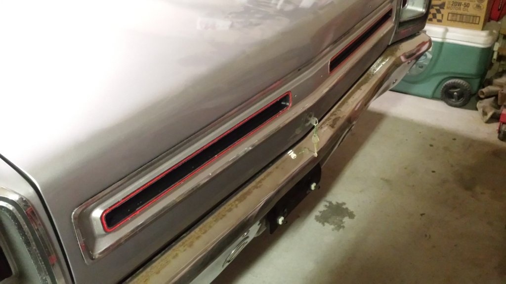

I cleaned the tail panel up a bit. The areas with paint I dremeled the pits and went over with body glazing compound. Used silver krylon and brownells flat black. The red outline was done with ss urethane and a paint brush. I still need to find an emblem for it.

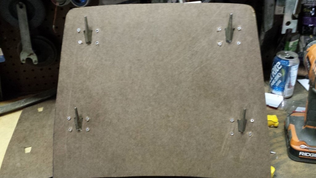

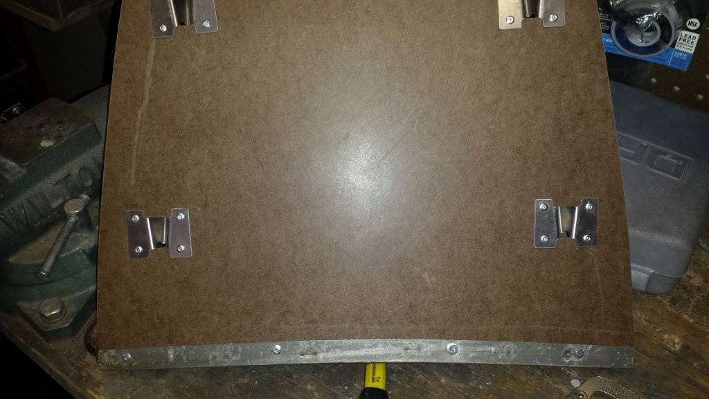

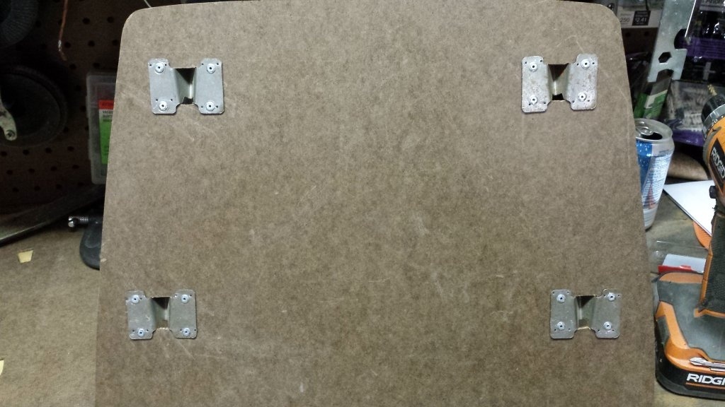

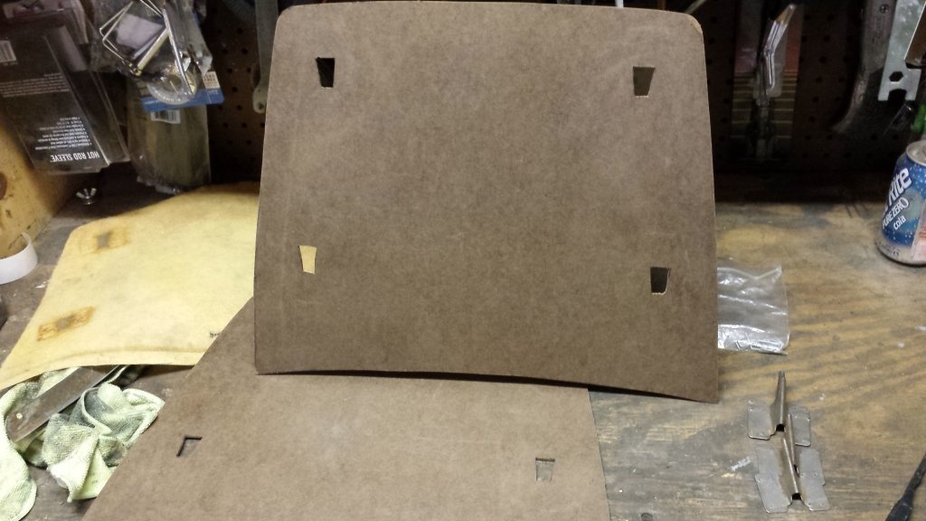

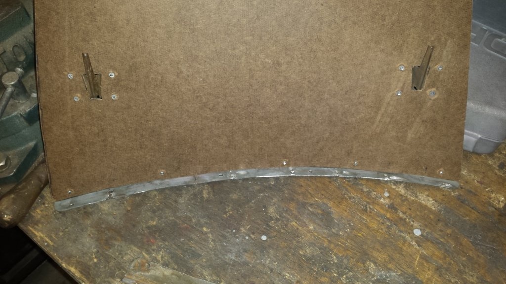

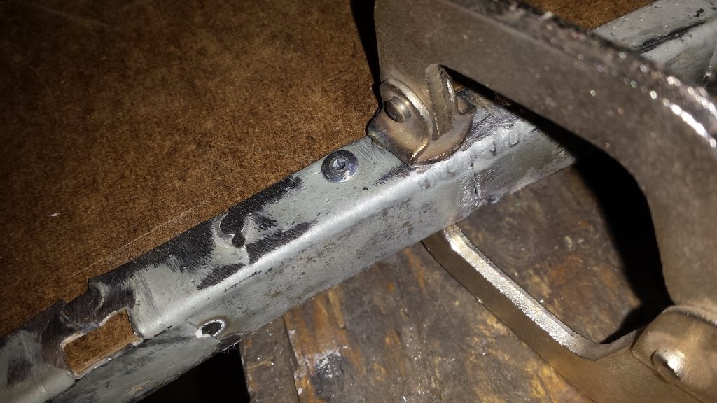

And I started on the seat backs. Had scrap masonite board laying around. Cut them to shape and then cut the holes. I bought a cheap rivet tool at Oreillys to put the new clips on. Since I ws missing a panrl I had to order 4 clips and will need to make the lower bracket. Once the panel was riveted, I flipped it over and planished the bottom. I will probably attach the lower strip with staples.

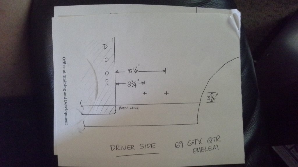

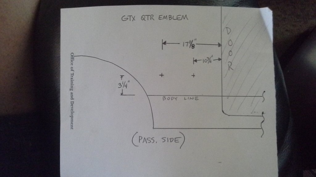

Could I get measurements for the big GTX emblem on the 1/4s I need to drill the holes for the studs and didn't record the locations. Not sure if they're the same on the pass & driver side.
They are different, the pins on the emblems are not centered. I think my measurements are at home so I'll post them up this afternoon. I still have to drill mine too which means quarter interior panels come off....again.

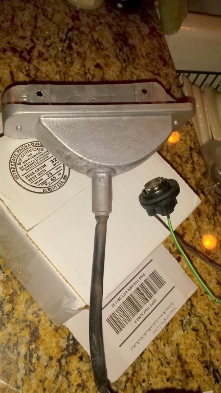

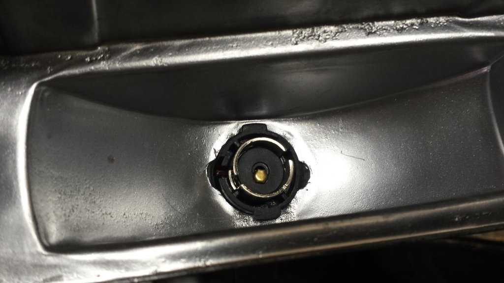

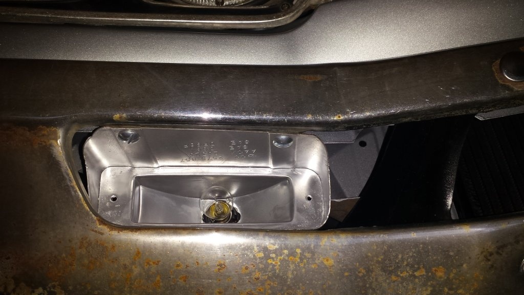

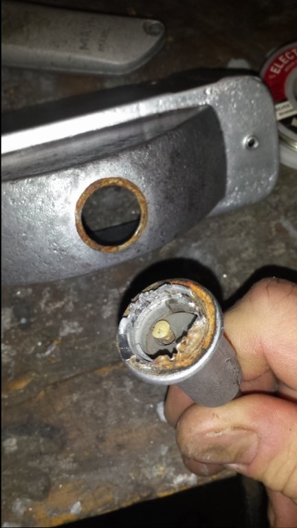

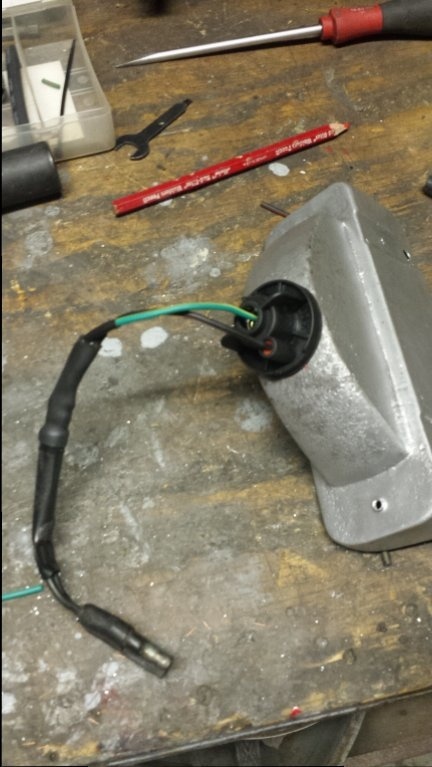

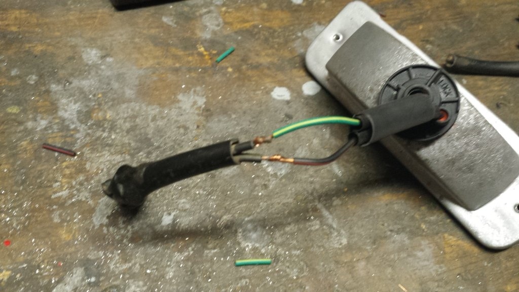

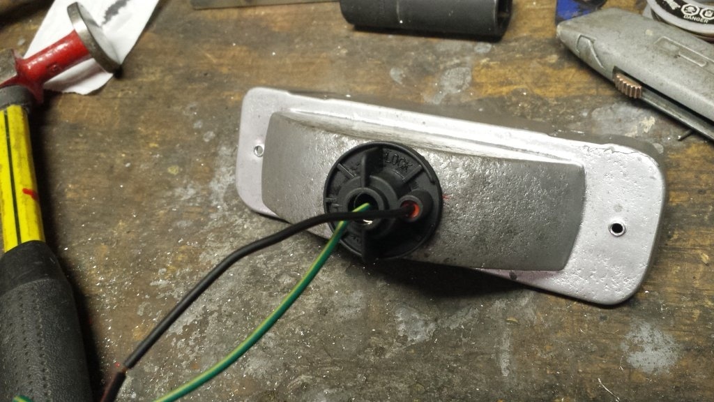

Front turn signals. My car had 3 of them, none installed. One was rusted and had no wires, one was missing the sleeve that holds the bulb and one would have worked ok. So, I modified the housings with new sockets. Found the sockets on Ebay for about $6 shipped a pair. I actually ordered another steel set to see if it would fit in the housing (which it didn't).

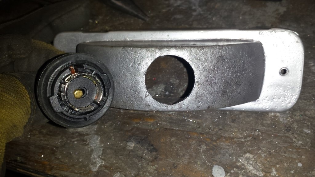

So a bent the flange of the socket back and removed the old socket from the housing.
Then I took the dremel to the opening using a socket as a size reference. Once it was opened enough, dremel or file two relief cuts for the tabs. Insert and twist and solder up the 2 prong terminal.

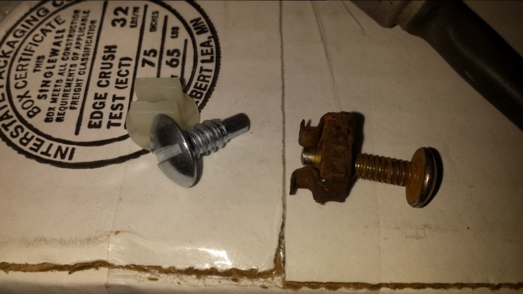

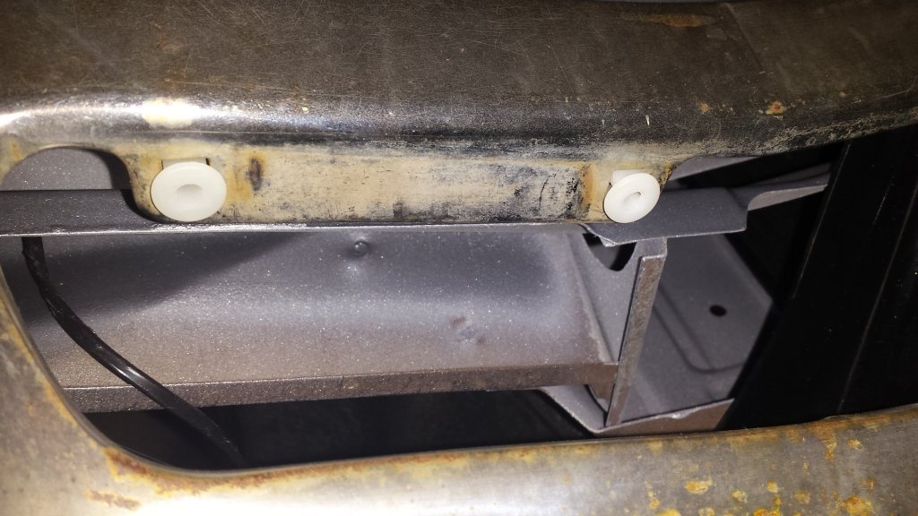

To mount it, the original had cage nuts (10-24) that held it in place. I had a hard time finding a place that sold these in lots less than 50 pieces or had expensive ones that were "restoration quality." I picked up these license plate anchors and used them for the princely sum of .97 a pair.

Got the seat backs together, should get the covers this week. Fabricated the other bracket from an extra c pillar headliner mount strip.
