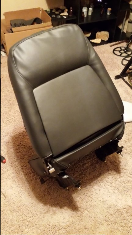

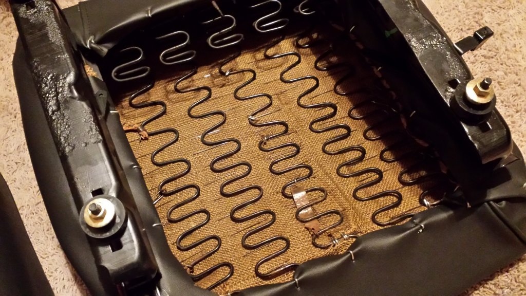

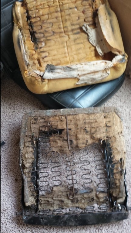

Got the driver seat cover installed. Shop did a pretty good job without having the seat frame to go off. Used hog rings all around. I still need to cover the back panel. I reused the old foam as it wasn't really bad. I did put in new seat bottom burlap (I used army sand bags lol).
Old bottom
New
Not bad for $120

The worse part about the seat was threading that stupid wire through the burlap. I do that to make it look factory yet I use chinese turn signal sockets :realcrazy:

One seat back done and screwed in. I also got the seat installed in the car....sure is comfy!

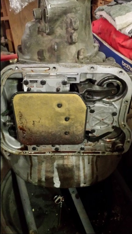

Teardown of the 727. New parts: Complete rebuild kit, new mrrandy billet LR servo and Front Kickdown servo, Transgo TF2, new sprag rollers/springs, 5800rpm governor, heavy duty band strut, 3.8 lever.
I will start with the Transgo TF2 install and get it out of the way. I pulled the pan (which is pitted and have a new one on the way) and removed the valve body. Inside isn't bad. Took some pics but the service manual and Monroe's book will be fine for reference. Cleaned up the parts with mineral spirits/atf mix and a paint brush.
