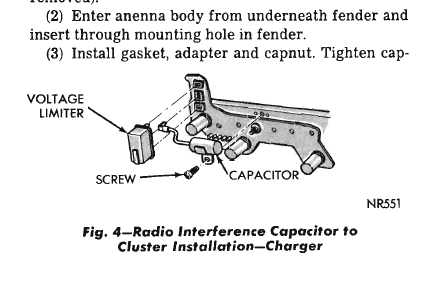

Was changing my voltage limiter on 69 cluster the round condenser wire was not plugged in .My question guys were does it plug into and what is it for? If any one has pics thanks
Oh ok any idea were it plugs into the end of it is just a flat spade end
