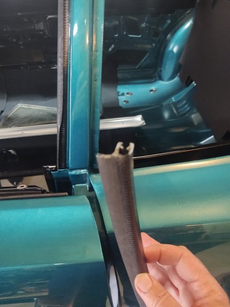

Hello, does anyone remake the interior post covers for a 69 Bee. Not the front pillar, i have two sets of those. If not, are all 68-70 b body post covers the same?
If you mean the interior trim that presses on the post pinch weld ....not reproduced....I should have some
Thanks guys. I was missing most of the interior but had a hardtop to use. I'd like to find a post car in my area to actually see what I'm missing. I'll keep you in mind Steve.
?? What "post covers" ?? I thought those are welded on !!
They are, but they have an f shaped rubber trim slipped on each side of post with grain like the ones on the lower door opening. On my phone ....so no pics to show. They're clearly shown in my Bee resto thread.
You might try restorationspecialties.com for that upper B-pillar pinchweld trim. They're a good source for fasteners & windlace & clips.
A few years back I bought some F-shaped trim like that to seal off a radiator to its opening, may have bought it from them.
Do you know where to get any of the f type post pinch weld?
