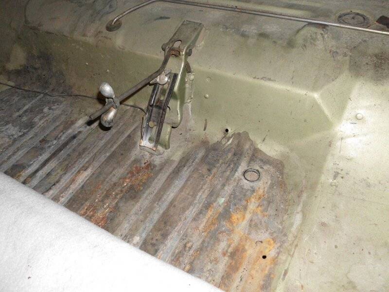

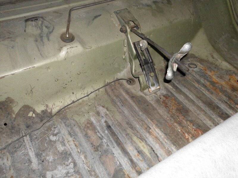

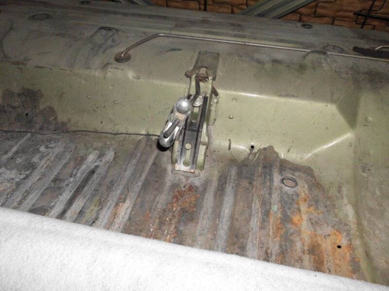

Trying to get jack and mounting bracket back in trunk. Need pics on how and where bracket mounts. Location of threaded rod. Trunk pan has been replaced and no hole or mounting location. Any info would help.
Here's my 69. The threaded rod is just stuck in there to show it's approximate position relating to the rest of the components. Hope this helps.
Great info. Good pics. That will get me close. Looks like it is welded to trunk pan. Who ever had car before me installed new trunk pan and didn't put bracket back in it. Thanks for the pics.
