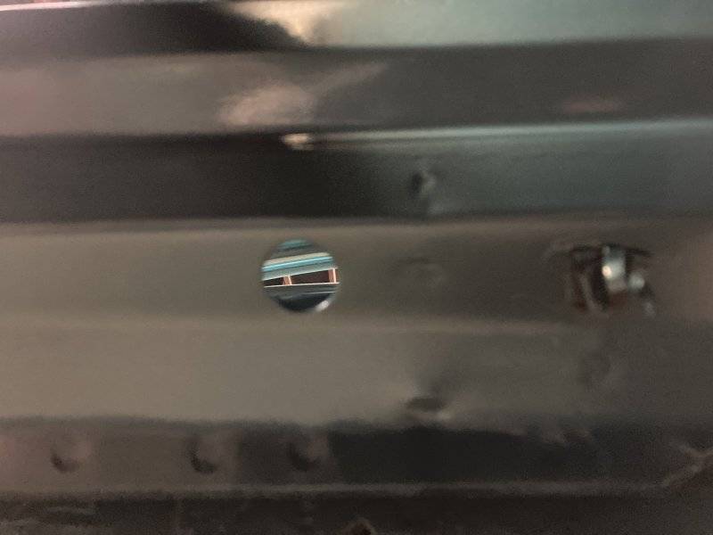

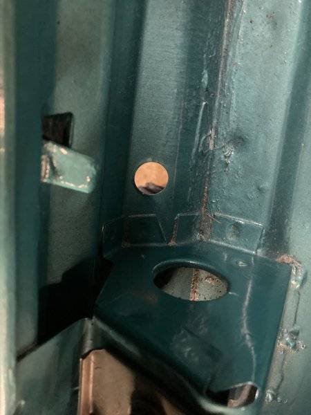

Can someone send me a pick on where the licence plate wiring goes through the trunck to the outside. Mine was all rusted out and is going to get a patch. Need to see location and rubber grommet size. Thanks
Dodge..but imagine it's pretty similar.. small hole beside the wiring clip. Mind you Plymouth has the full trunk tail panel, so you may want to wait for a Plymouth picture.

my '69 road runner had the wire hole in the same spot as your Bee.
hope this helps these are from my 69 road runner
Thank u that helps alot . Somebody before me had tried to represent rust in that area and there was no hole. That gives me a location for that hole. Thank you .
