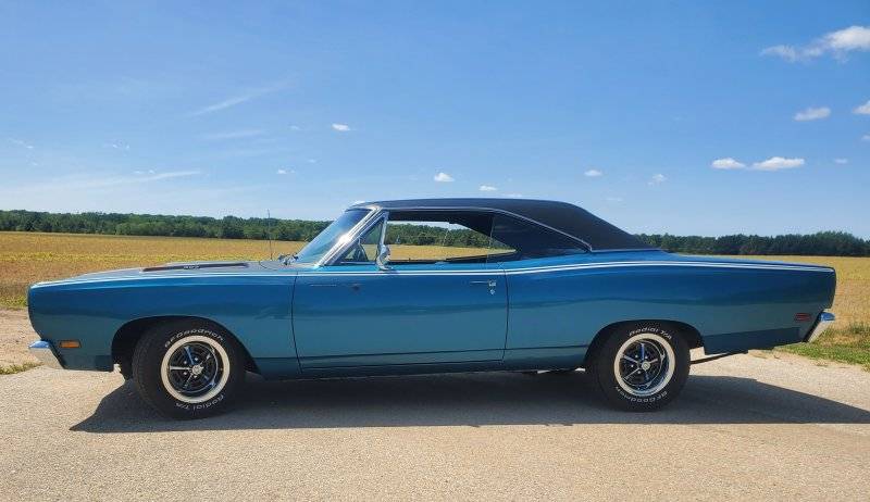

1969 Roadrunner Hardtop rear quarter window wont go down easy.
NORTHUP87
New Member
5:34 PM
Mar 17, 2023
2
8
Newberry Michigan
Hey guys hoping the pro's from dover can assist.
This may well be a bushing or regulator issue but I wanted a quick consult before I order.
The window will not cycle down easily you almost need to hammer the handle and pull down on the window, but when it's down it rolls up smoothly with nearly no effort which makes me think the regulator is fine.
Thoughts?
Thanks A.J
There are a number of rollers that can rust to the shafts or break. Go on youtube and search " mopar B body rear window regulator removal" for an idea of the parts.
I've had my current street B-body for now 6 years. And I don't recall ever trying the rear windows? Lol.
Something to check to tomorrow before the Sunday cruse.
Oops. I'm wrong. I rolled all down when for purchased for pics. If I remember right they were alittle tighter.
