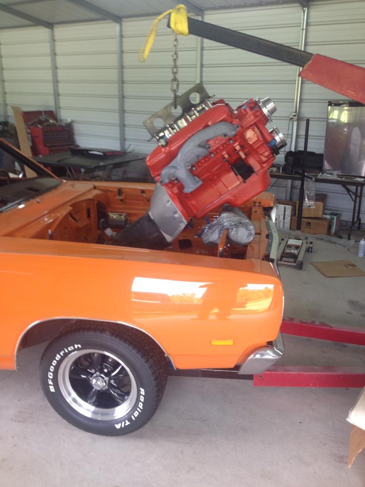

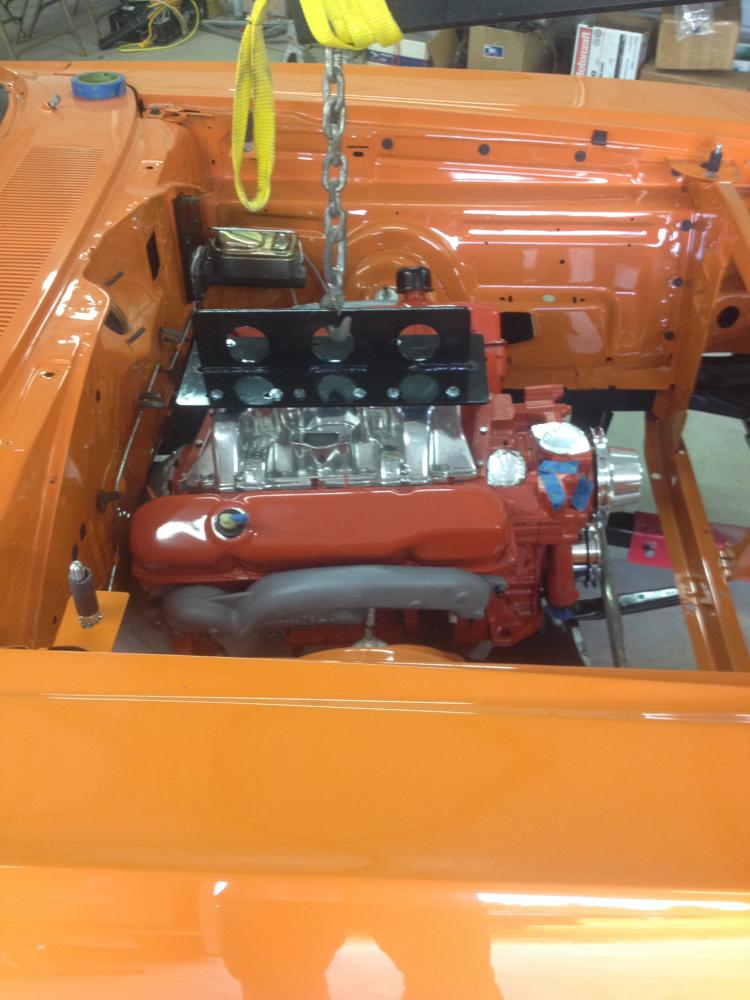

It did fit !

Thanks. I had chewed on taking the K-member back out and putting it in from the bottom, but I read a post on here about how easy it was to do from the top. Boy am I glad I did it from the top. One person helping and thirty minutes later and it was bolted in.
Nice. Put headers on it.

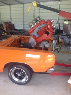

Nice looking install. Did you jack up the back of the car for a better angle?
Thought about it but it was'nt necessary. I took a small come-along and hooked it to a strap to level the engine. Once I rolled the car under it l let off the come-along and eased it in. Was not near as bad as I thought it was going to be,
