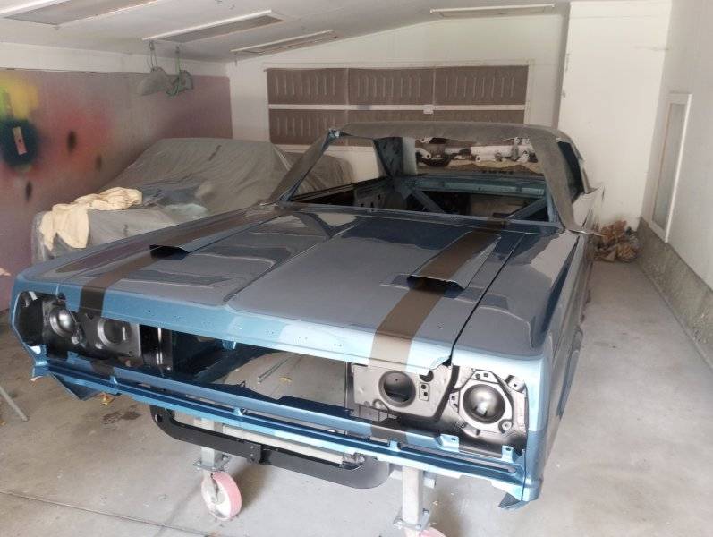

@mopar4don is painting his Charger that color. I can't remember what brand of paint he is using, but what he sprayed so far looked nice. Maybe he wil chime in.​

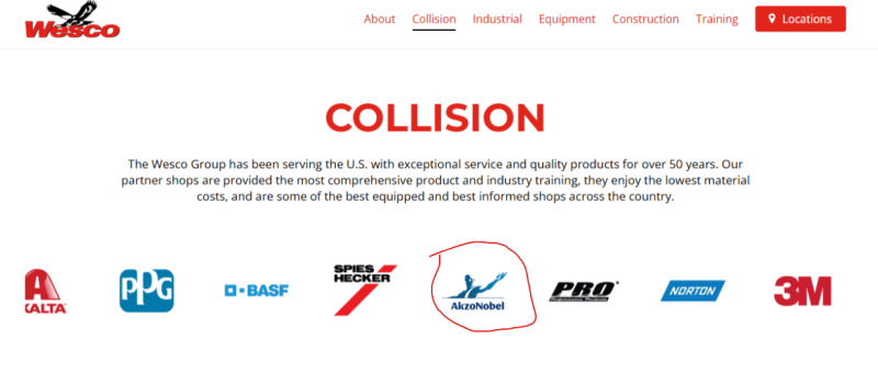

The ONLY paint supplier in my area is Wesco. Funny that I can get in PPG but not Omni that is also a product of PPG?

Wanda by Akzo Nobel (Lesenol, Sikkens) is good stuff and lower priced

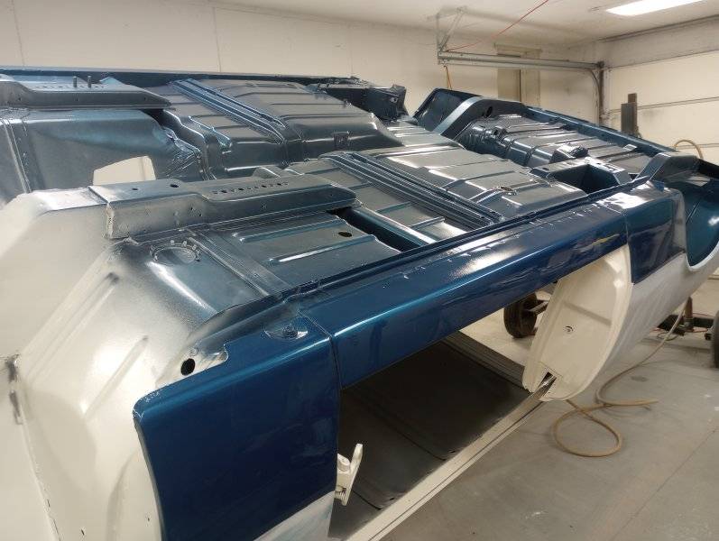

460 / gallon for the 1967 881 bright blue within the last 2 years....... Hemi Orange was closer to 600

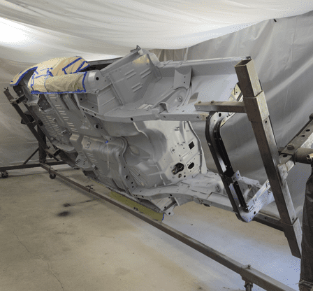

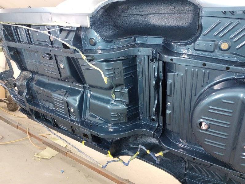

I used Wanda on my RR and it worked great. The bottom of the package tray inside the trunk was my favorite part. Well you are on a rotisserie so not as bad as laying on your back inside the trunk

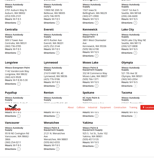

Car looks great. I don't see any Wanda dealers for retail in my state (WA) Where did you get your paint?
