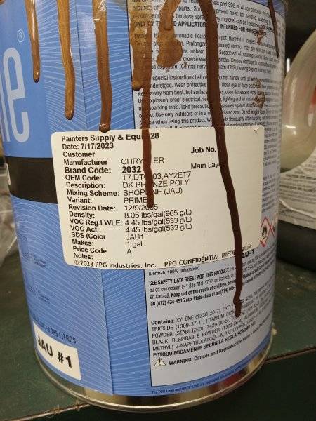

So it looks like in July 2023 I paid 278.88 for
1 gal lacquer thinner,
1 gal grease and wax remover,
a package of tack cloths,
1 gal of PPG Shop Line JAUJBA/GL 2032 dk bronz poly (not sure what the JBA/GL is??? maybe the hardener and reducer?)
These were purchased from our local PPG paint supplier, Painters Supply and Equipment Company

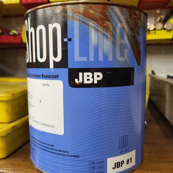

Shopline JBP base/clear for bottom and inside of car. Deltron for the exterior. This was T5 copper for my Bee, and I did the same with B5 blue on my Runner. Although they are the same codes, they definitely don't match when laid side by side.
