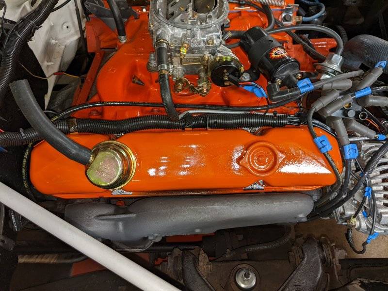

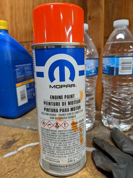

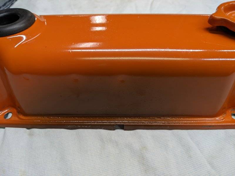

Ran up against this problem when switching from chrome valve covers to stock. I have 1969 HP Exhaust Manifolds with stock 1970 Valve Covers. I used Chrysler Race Hemi Orange (pic below) to paint the valve covers (s/b Street Hemi Orange). I did not use primer. Clearance on the right side from HP exhaust manifold 2806900 to the valve cover is tight. After 30 miles of driving, I had burnt orange (pics below). Paint on left side valve cover also burning/bubbling.
I have also tried Duplicolor Hemi Orange. It flakes badly.
These manifolds destroy cork valve cover gaskets.
Car is not running lean or knocking. Engine runs excellent.
Is there a hemi orange paint that does not burn with these HP exhaust manifolds?
Is there a primer or clear coat that keeps the paint from burning with these HP exhaust manifolds?
Do I have to use an exhaust manifold gasket like Fel-Pro MS 90425 because the paint will burn otherwise, regardless of which paint I use?

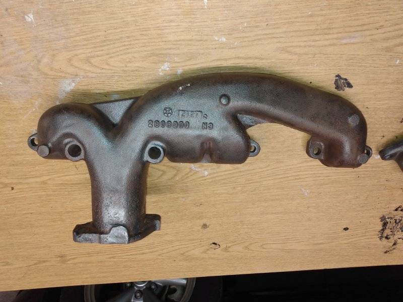

2806900 HP Exhaust Manifold fits B-Body & C-Body Right side

Close Proximity mount
Race Hemi now burnt orange

Your pic above is of 1968-79 RH manifold. The proper 70 manifold is 2899879. This would not have an effect on your paint....just thought you want to know the correct part number.
Accidental typo.
Meant 1968-69. Just to avoid confusion.
Corrected date in OP to 1969,
Since you know these manifolds, any suggestions on paint that will take the heat?

What paint are you using on the valve covers?
@33 IMP says I chose lousy paint, different thread.
I would find the thickest gasket between head and manifold that would fit therefore putting the manifold farther away from valve cover
