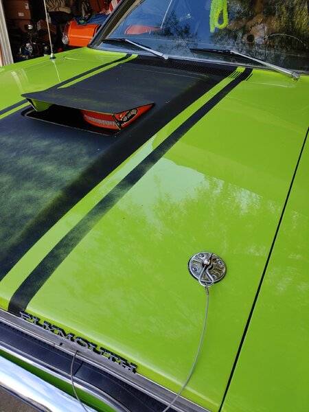

Hey has anyone converted their air grabber hood from vacuum to electric..
I've just heard a lot of horror stories about vacuum actuators going bad pretty quickly.. I've been looking at a 2" electric acuator n ther fairly cheap.. Any pics would b greatly appreciated.

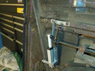

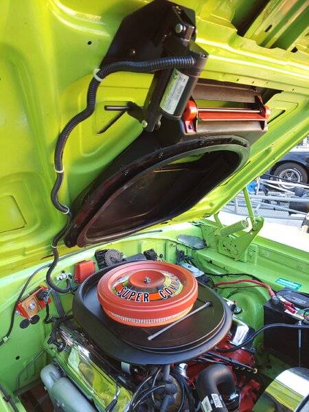

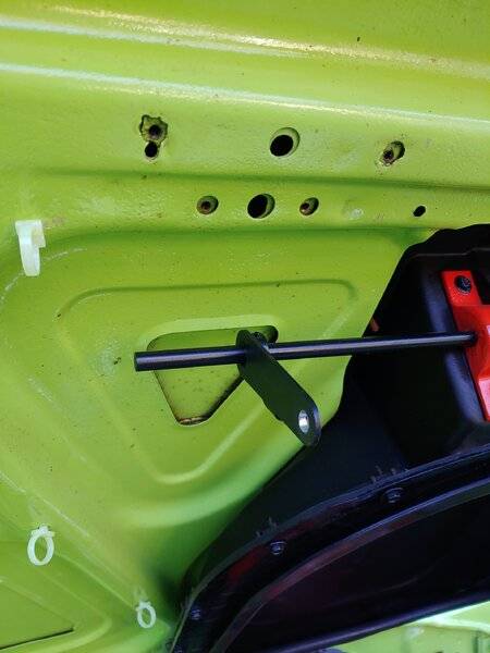

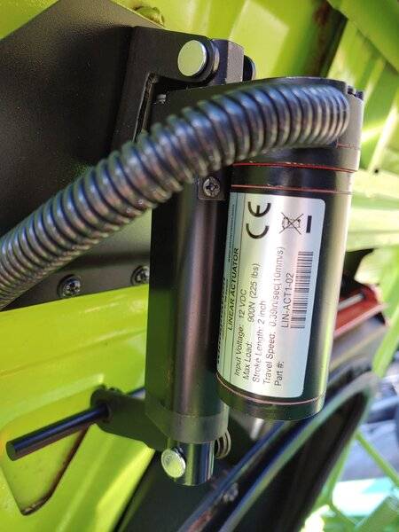

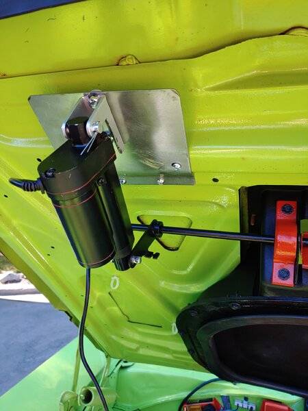

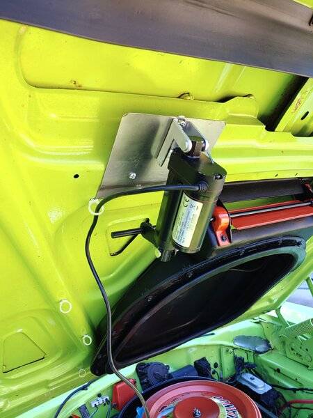

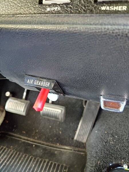

The bottom pic is my Road Runner. I did this a few years ago using a 2" actuator and home made bracket. I'd prefer the stock setup but the aftermarket vacuum actuators you can buy are junk, the one I bought lasted a month.

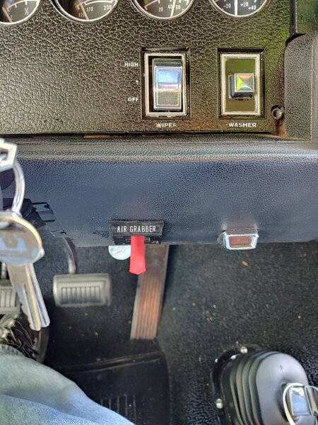

I'll post some pics on what I did.. I used the stock location for the actuator and switch..
Here ya go..
The 2" actuator is from Windy Nation water proof for outdoor use.

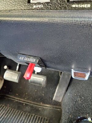

The switch is IndusTec 10 AMP DC Motor Polarity - Reversing Maintained Toggle Switch Wired 12V also I put a toggle switch extension "RED" I cut the extension down a 1/4"

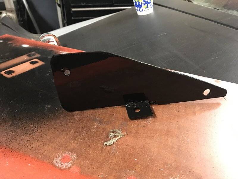

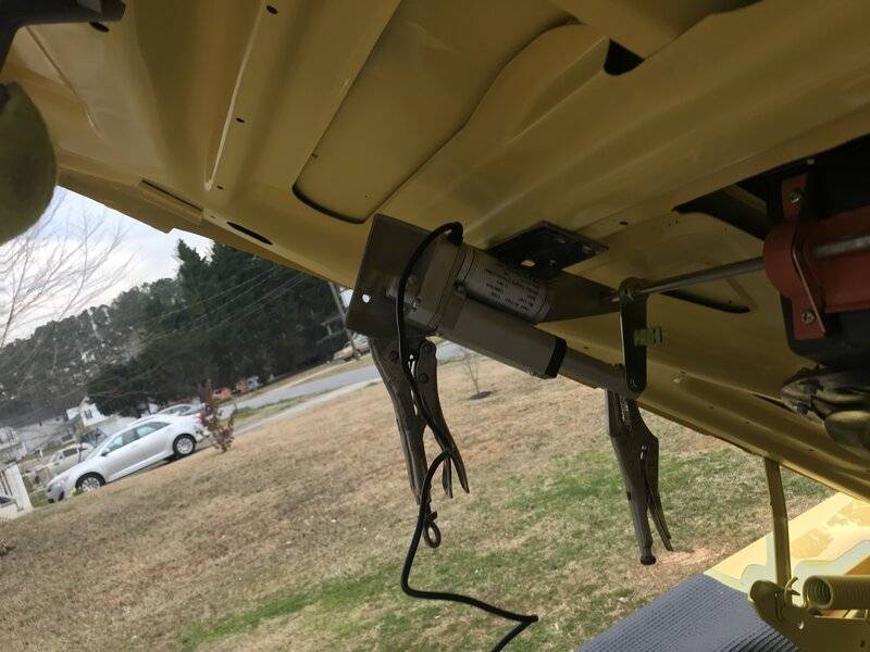

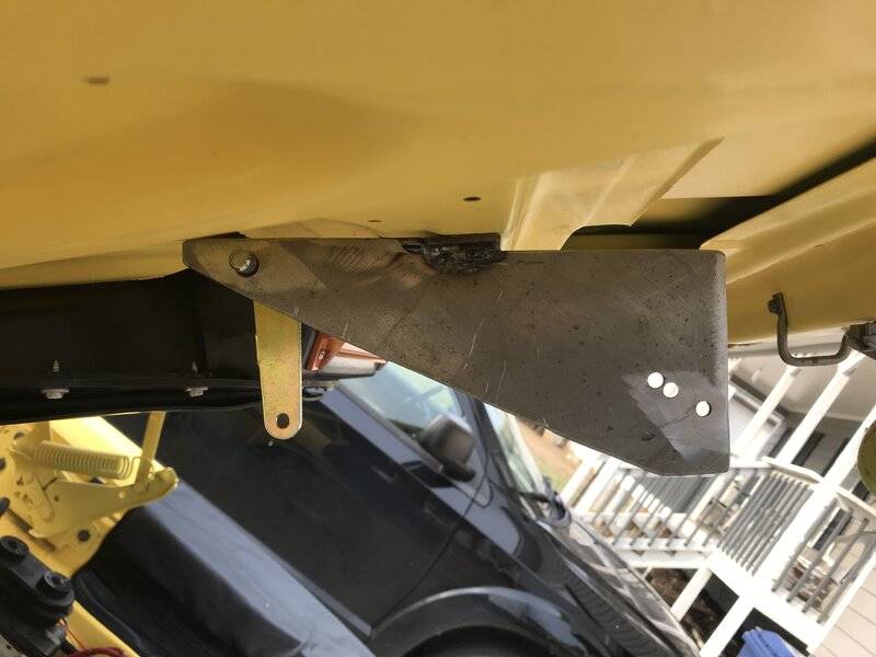

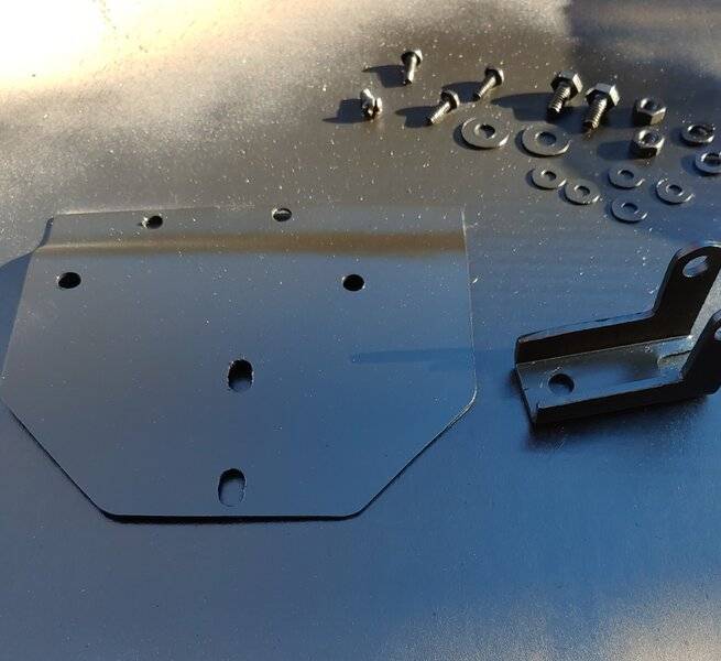

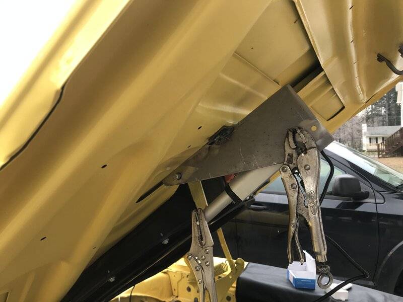

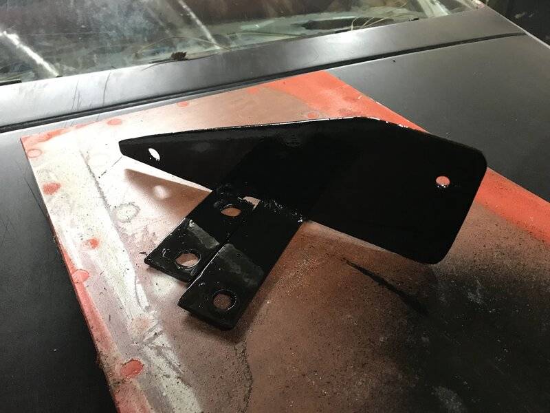

I made a bracket for this today. Almost like the 70chall440 posted. I have some pictures it was a little trial and error but in the end I have a functional bracket.

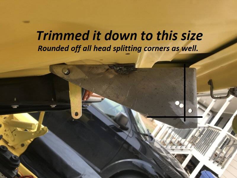

This is the bracket roughed in and a little bigger than it needed to be. I have trimmed it down and reduced the length as well. I will post some more pictures as it progresses.

I have been screwing around with the vacuum cannister and actuator for the last week; I love this idea for an electronic conversion. @dgkirkman that mounting plate is sharp; any chance you could be paid to make another one or I'm going to start fabricating.
Are you asking me to make you a bracket? I can if need be. Lol never mind I forgot he had his own on here.
Here ya go..
The switch is IndusTec 10 AMP DC Motor Polarity - Reversing Maintained Toggle Switch Wired 12V also I put a toggle switch extension "RED" I cut the extension down a 1/4"View attachment 1060779 View attachment 1060780 View attachment 1060781 View attachment 1060782 View attachment 1060783 View attachment 1060784 View attachment 1060785 View attachment 1060786 View attachment 1060787 View attachment 1060792

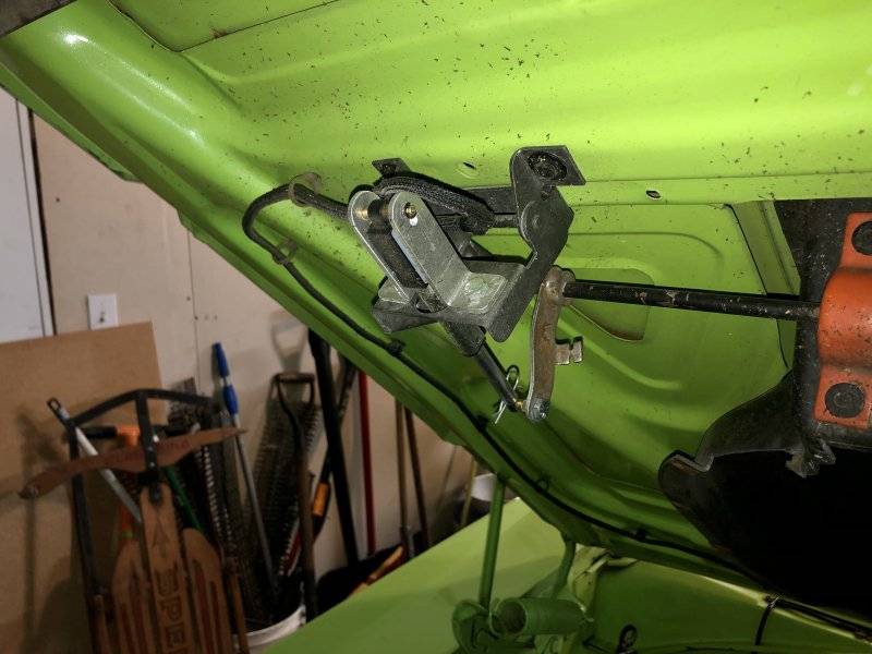

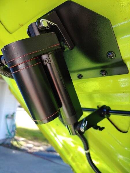

You guys are using some beefy actuators. I used those on my Superbird headlights. For the Air Grabber, I used the stock bracket and adapted a smaller linear actuator.
