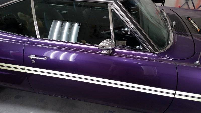

Just a guess but probably 12-15% of production got dual mirrors...
....with the Sport mirror being the rarest. My GTX didn't have it coded, but I managed to buy one many years ago, and the new owner had it fitted to the car.
The car was coded for the drivers side sport mirror.
Black stripe BTW....photographic reflection at play there.

Reflective black - it was ordered by mistake apparently....after I sold the car it needed some paint repairs...as the result of an incident.

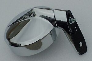

My 69 Bee has a right side mirror. I bought a replacement at Mega Parts when I restored the car.
Door Mirror, Right 1967-74 A-Body, 1967-70 B-Body, Mirror A-Body, 205-OSM869R Reproduction, NOS and Used Mopar Muscle Car Parts
This one is used if your left side is a remote. There is a different one if you have a non remote left side.
