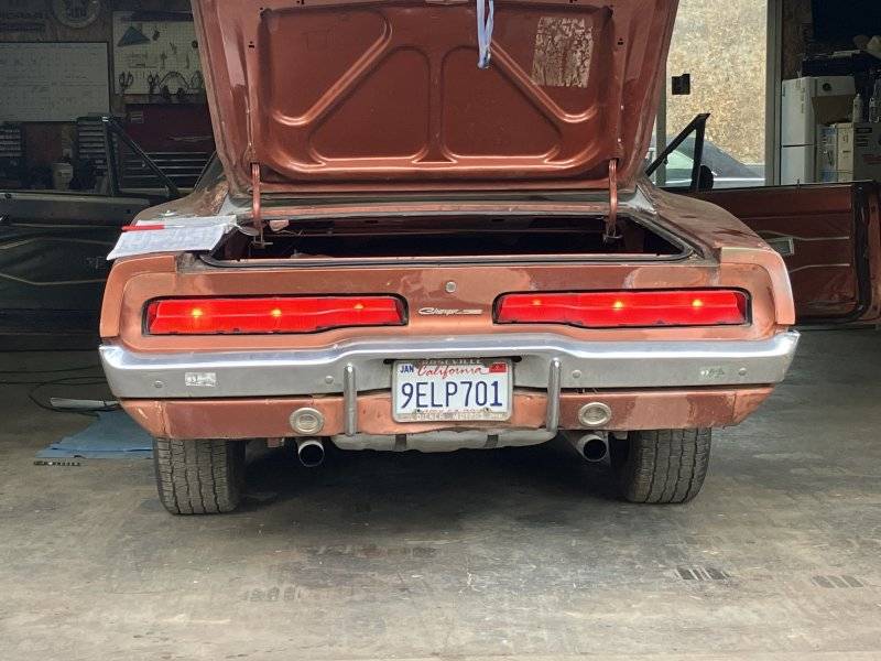

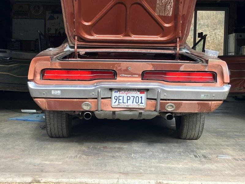

Below, brake lights only:
Brake and tail but the inner bulbs do look pretty bright….
The middle and outer are still brighter than the inners.
