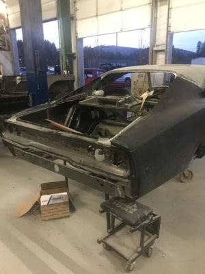

Inside the trunk below the "Dutchman" panel is this structure with the square holes in it.

This bulky thing looks like a suitcase. Both of my 1970 Chargers have this. I cannot understand why this is here. It takes up space and seems to serve no function but there must be a reason for it, right?

Maybe it is just an elaborate way to support the Dutchman and to provide support for the trunk lid.
Ssmoothie...That picture does help. Thank you to you and everyone else.
I now think that since the Dutchman is flat, it probably has less strength on it's own. This "suitcase" probably provides support for both the Dutchman and the trunk lid and hinges/torsion rods.
Kern, I think you are on to something there.
If you look at a standard B Dutchman, it is short and has a curvature.....somewhat self supporting. Those two braces on a belvedere or coronet are enough to give a little triangulation support in the middle by going back to the speaker tray. The charger is long and flat and needs a little triangulation and boxing to get the support.
Just think of it if you grabbed the trunk gutter in the middle of the Dutchman and put your full body weight on it. Without the bracing they would all buckle. For the coronet and belvedere, those two braces are enough to triangulate back to the speaker panel area to provide sufficient support. If the charger simply used those two supports....it would still buckle. If they built the supports to be triangulated like the sides only (without boxing) then the support braces would splay outward and the braces would still not prevent the gutter from buckling. By triangulating and boxing they keep it from buckling in the middle and bending downward from the window.
At least that's my theory.
