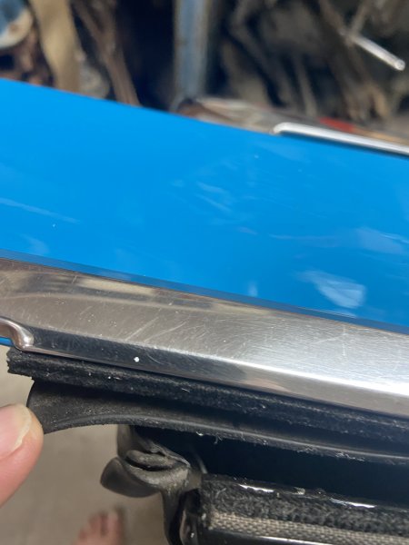

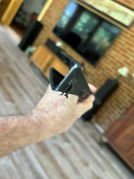

hello all, I have a question to anyone who can help on this. I am finishing up a 1970 Charger 500 restoration project. I am looking at the set of window felts from DMT and have a problem figuring out how they are supposed to be installed. I am posting a couple of pictures to help explain my questions to all of you.
The outside front and rear are shown in the pictures. You can see that if the felts are installed from top to bottom (as all the ones I have ever installed are) leaves (logically to me) the felt upside down with the trough positioned to just collect water. To me the clips are upside down. I am open to telling me this is how they are supposed to be installed but I find that hard to believe. DMT says to rely on your judgements! I very much appreciate your advise on this matter!
Install from the top. The slide clips will guide you to the right location. I have pictures if you need then.
