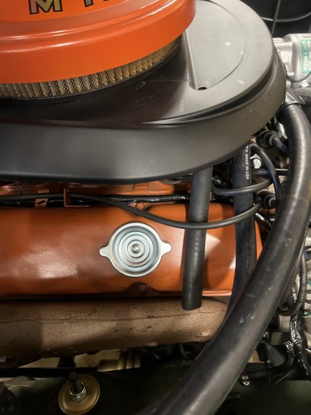

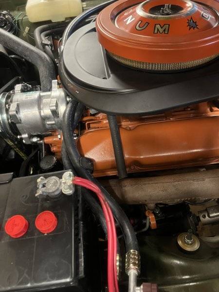

I installed the drain lines in the N96 base for the Ramcharger. I used 1/2 inch heater hose I cut them so they drain past the valve covers. Without them water would just collect in the valley tray.
