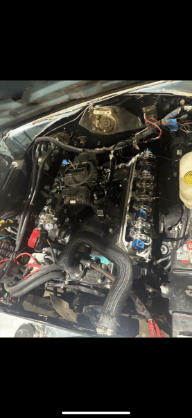

I present you - The max wedge RV 440.
Sometime next week I get to pick up my machined short block pieces to replace the leaker/oil eater 440 thats in the wagon now. As I make more dough, will gather parts up so I can assemble it.
