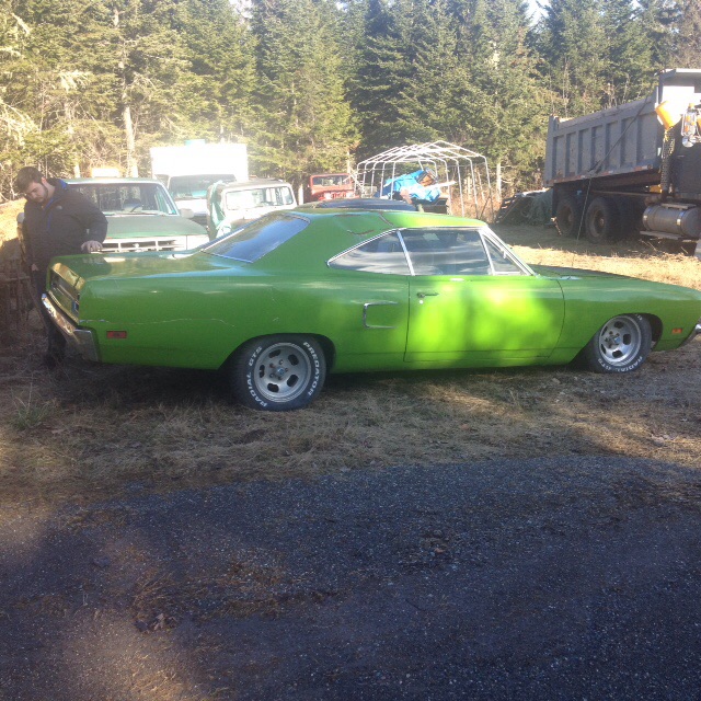

I need some help! My son and I just went to look at a 1970 which has been in storage since 1992. It just came out when the garage colapse from snow on the roof. The question is what could be wrong with the front end, the frame looks solid, but it is touching the ground! We could not look enough under and the hood hinges were rusted so we could not open the hood to look in. The price is right but it would be nice to know what We're dealing with.
Thanks for your help!

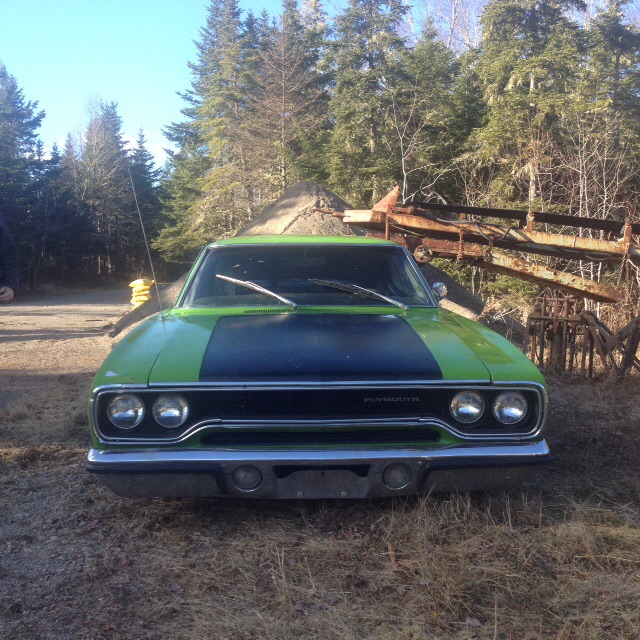

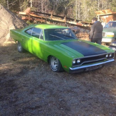

Torsion bars may be either removed or adjusted right down looking at pics supplied.
It happened over time. Driver side first then passenger!
Thanks 70Gtx. If it is the crossmember rusted through, how big of a job is that to fix?
rusted through. looks like a good assumption to me too. weld a new one in. looks like a good car from here. price is right you say?
If it happened over time, then I would agree with the torsion cross member being rusted through, but I agree with Kiwi, the rest of the car doesn't look like a total rust bucket.
It has to be one of two things: Severe rust or somebody was messing with it.
Can torsion cross members be replaced? Sure, but if rust has attacked them there are almost definitely other rust issues. Maybe try to get under here with a mirror, or stick your cell phone camera under and take lots of pictures and see what you can see. Better yet, jack up the front end, support the car to make it safe (e.g. jackstands) and crawl around...
Best of luck - otherwise, the car looks really good...
Like my dart when I bought it... a torsion bar was snapped. When I removed it and looked close, it looked like something had hit it and thats where the failure happened.
... yes may be the cross member, you should be able to see it with a flashlight from the other side so get on the ground and look and it may be a negotiating point on the deal too and liiks like a good lookin car but ya never know if its just a skin job
Price is right but it has a 318. I have a spare 383 but my son is leaning towards a 440 six pack.
right on! Beautiful find BTW!
Shouldnt be too hard to get a bigblock and 727 in there with the proper mounts... just need to shorten the drive shaft 4" or so. 6 pack be cool
(unless its standard already then just the bell)
Hey guys, my son and I finally got to pickup the car earlier this week. It had been in storage since 2002, not 1992. My mistake! It was near 0F with a 30-40 mph wind. Not great to pickup a car but we wanted to pick it up before the snow.
we got it jacked up and blocked. It was the torsion cross member. It has minor rust in the floor and trunk. It will need a lot of work! We found a 4 speed A833 in the trunk and an extra front grill, GTX style.
