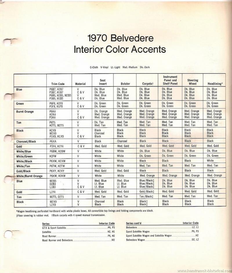

The P6XW is for your interior, the P6 being for bucket seats and the X & W, black and white. You can see the chart below for what should be black and what should be white. I have the same on my 70RR, except I have the bench. If that is a FT6 next to the P6XW, then yes the color is burnt tan metallic. If that is an EW1 to the right of the P6XW, then your upper door frames inside will be alpine white.

What about the exterior stripes? Why does that come up as plumy crazy longitudinal stripes? v6c or v6g

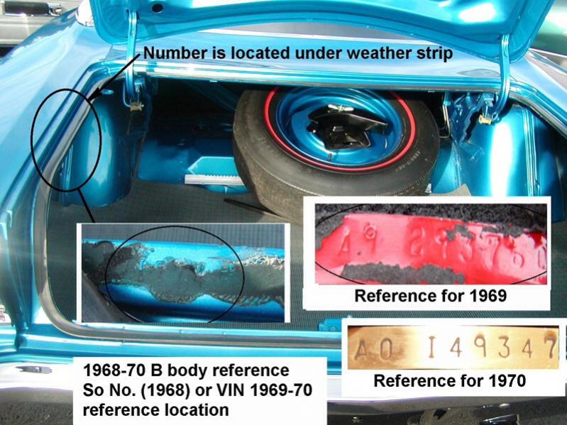

anyone know where the other vin locations are? Is it same locations as 69? radiator support? trunk drip rail? thanks.
Yep, radiator support and then the trunk lip on the drivers side. See below pic for approximate trunk lip location.
