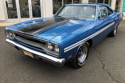

Enough with reminiscing. Now we have a 1970 GTX just a step above the Roadrunner. This has the 440, power front disc brakes, power steering, Automatic Transmission, A/C, Tic-Tac-Clock, upgraded interior with bucket seats, console and looped pile carpet in blue. The outside paint is B5 blue riding on Rally chrome wheels.
Currently I'm want to upgrade and install a complete speed (cruise) control system for the 70 GTX. I've read in some messages on "For B Bodies" different members have it all ready or are trying to install speed control on their B Bodies. Does anyone have available or knows someone I could contact to purchase the parts necessary to install on my 70 GTX? There are numerous parts involved. Servo, cable, hoses, wiring harness, brackets, linkage, bolts, clips, speed control/turn signal stalk, Brake switch just to name a few.

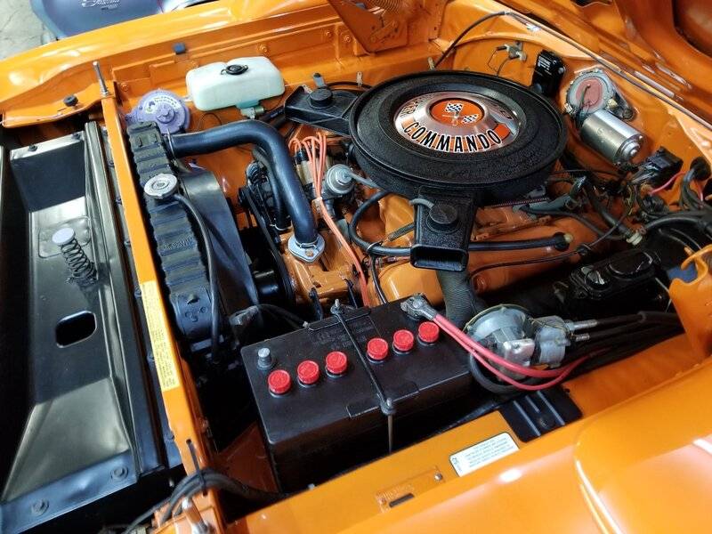

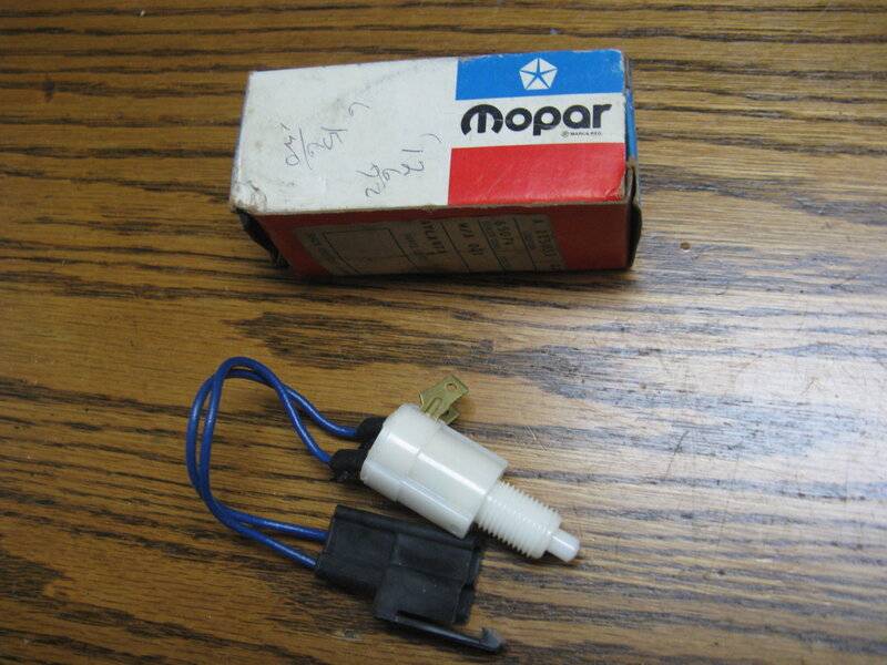

When you get down on your list of special parts, to the unique brake light switch, contact me. They are extremely hard to come by. My cruise control was dealer added when my Superbird was new. Some say it's a 71 unit, but honestly I couldn't tell you the difference. I still have 4 or 5 of the switches.
Welcome to FBBO from Ontario. That is a great looking GTX. I am using a complete cruise control system on my 1964 Polara that I removed from a first generation Cordoba. At the time I acquired it (30 years ago), these were plentiful in junk yards, but now not so much. Also, a lot of c-body cars had the same setup.
When you get down on your list of special parts, to the unique brake light switch, contact me. They are extremely hard to come by. My cruise control was dealer added when my Superbird was new. Some say it's a 71 unit, but honestly I couldn't tell you the difference. I still have 4 or 5 of the switches. View attachment 1206490
I recently needed a new switch for my car, but could not find a Chrysler switch to do the job. I sourced a GM switch on Rockauto that will do the job for a 1980 Buick. It does not look like the original, but functionally will work.
welcome to the site Mark sweet ride and good luck on your hunt for parts
I believe this is one if so I have an Nos one..

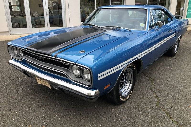

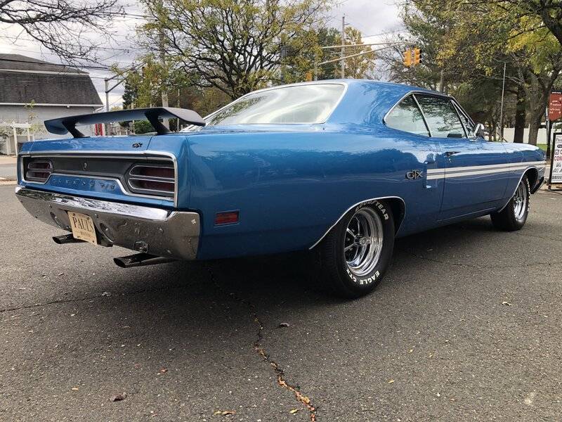

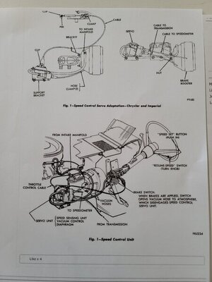

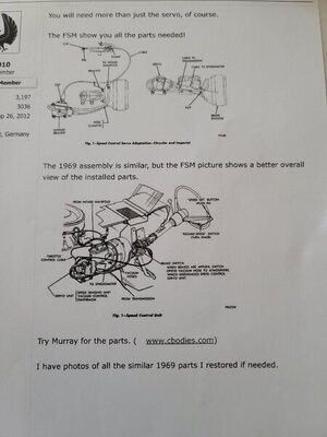

I've attached the Mopar diagram of parts and their location on a vehicle. This will allow you to identify what is needed and where it is located. Any questions please contact me.
