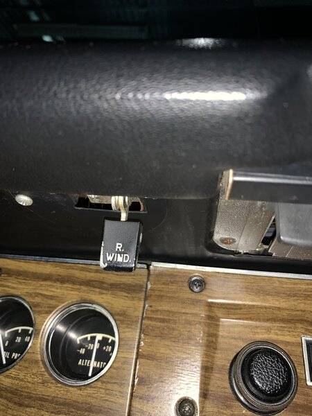

Apologies for the late pic, just went to the car in storage, here’s the switch locations

@charge70 - I'd be very interested in a template for that switch. My dash does not have any opening to the left of the heater/ a/c control panel, but I'm adding the rear defog setup and will need to cut the dash to mount it. I can't find many pictures besides the one I'm attaching....
I'd be interested in as many pics as you have of that area, and how the switch mounts/looks in the dash.
