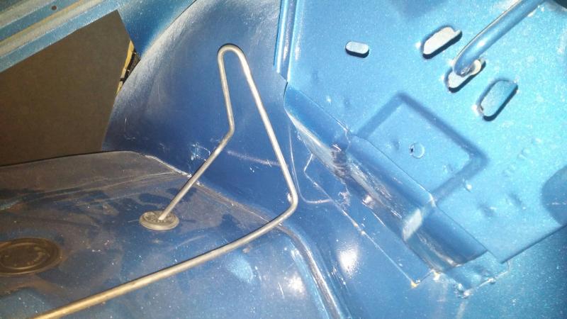

Lots here with this issue. Make sure that the loop is HIGH enough in the trunk first.

below is a picture of the loop in the trunk
The problem is that there are not enough bends in it. It should look more like this....
