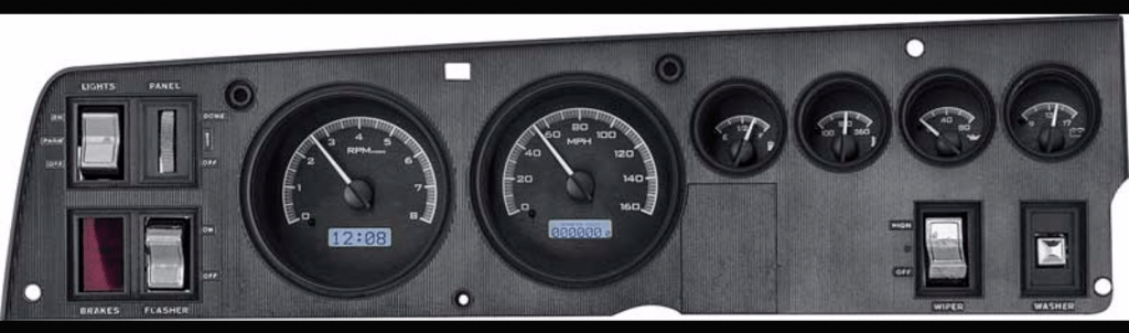

I just ordered the guage kit in the picture. Damn Classic Industries put it on the back cover of their Mopar catalog, so I see it every time I sit on the crapper (lol). Wound up getting a killer deal (cheaper than $903 from Classic w/MEM16 discount) from a "local" distributor. Even after I cleaned the potentiometer on my stock dash dimmer, although the brightness improved, it was still hard to see the gauges at night. Problem solved, now I just have to install them. I decided to get the red backlight since that won't affect my night vision.

Just got the gauge set today. Very nice! I see why the tach is included (not optional) all of the gauges are in a single enclosure. I'm excited about this, this isn't JUST replacement gauges, this IS updated and advanced technology and a big step up (IMO) on quality.
