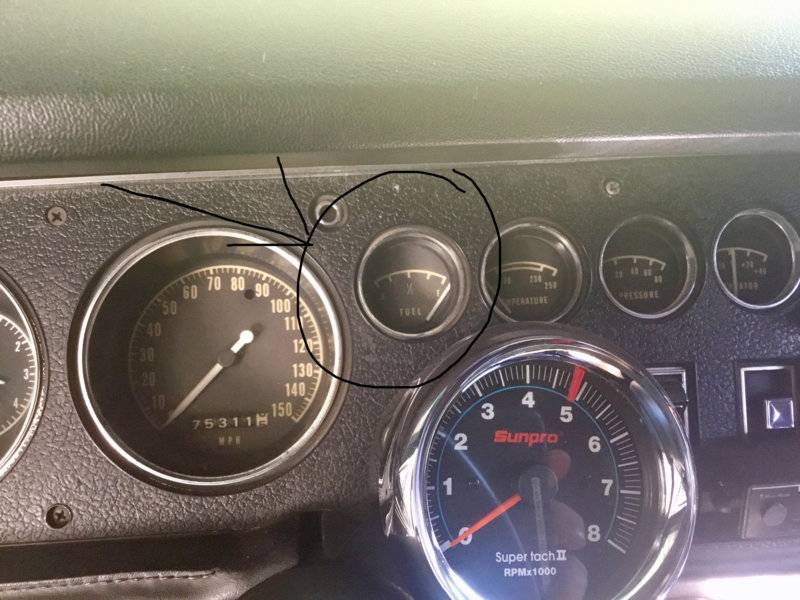

Can’t get fuel gauge to read full when the tank is full of gas
I have 2 sending units, one brand new the other looks original, when I hook them up out of the tank the sending units & the gauge in the car work perfect
But when I put them back in the tank they will only go to a little under ¾ when the tank is full
Has anybody had the same issue, and is there a fix
Thanks larry
You'll have to bend the arm a little one way or the other to get it to read where you want...a big hassle I know...mine read 1/2 with a full tank. I got it to read better but still not perfect, just haven't wanted to pull the tank down again....

thanks will try it
Also check the float. Sometimes they develop small holes because of the chemical additives in Gasoline. The floats gradually fill up and they become less buoyant causing the gauge to read inaccurately...cr8crshr/Tuck:thumbsup::thumbsup::thumbsup::usflag::usflag::usflag:
Don't know many who have not had this. Mine read 3/4 when full of years. You can bend it, but mine was a ground issue. Goes to full now.
Mine was reading 3/4 full, then one day I topped the tank to the max and ever since then it reads full when full (but now it shows empty when it has 4-5 gallons).
Agree with Dennis good solid ground is a must! I ran my own didn't trust that cheesy OEM clip
Same here empty with 4/5 gallons left. Different reason, in 1978 when I bought my car gas gauge didn't work. Pulled tank and resistor wire broken on empty end. No replacement, so remove 1 turn and resoldered it. So is empty is 1/4 full.
Mine has always read 3/4 when full. I don't worry about it. When it hits E, I fill it up again. Easy.
Finally was able to get the fuel gauge to read full with a full tank
Installed Bill Rolik sending unit, i could see that the neck on the BR unit sits lower in the tank than the one I pulled out & the first after market unit i bought
the other 2 units floats would hit the top of the tank in the 3/4 position

Ground issue per shop tech. It’s a mega $$$ custom tank from Ricks Tanks in El Paso to accommodate the new efi. It was fixed before that though.
