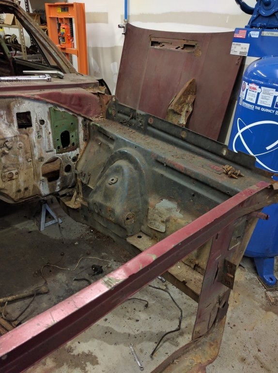

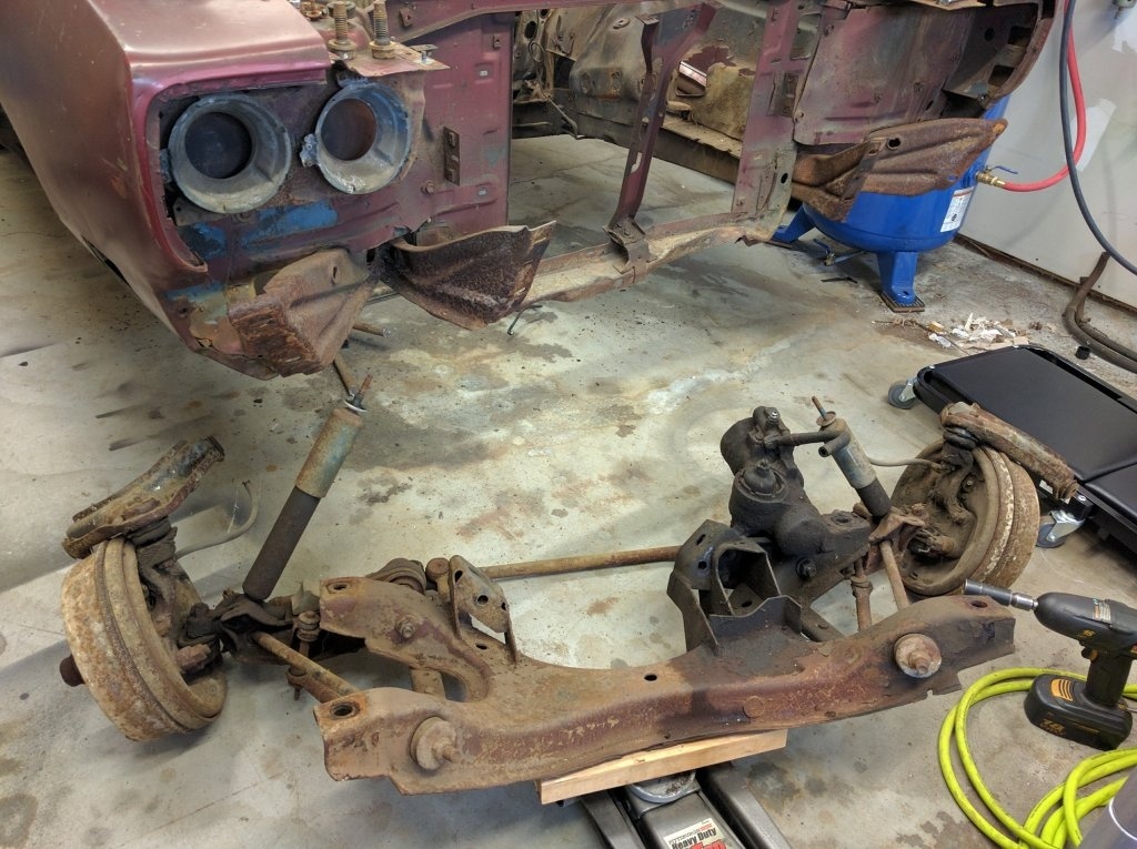

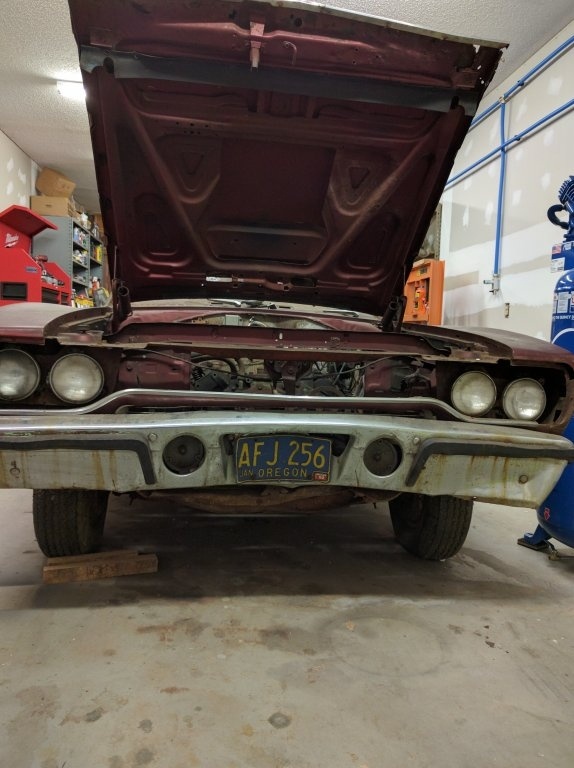

I moved up to the front of the car and removed the hood and hood hinges. Then the headlights and the lower grille piece, followed up by the front bumper. With all that out of the way, I pulled the original engine and stuffed it into a corner of the garage on a stand.

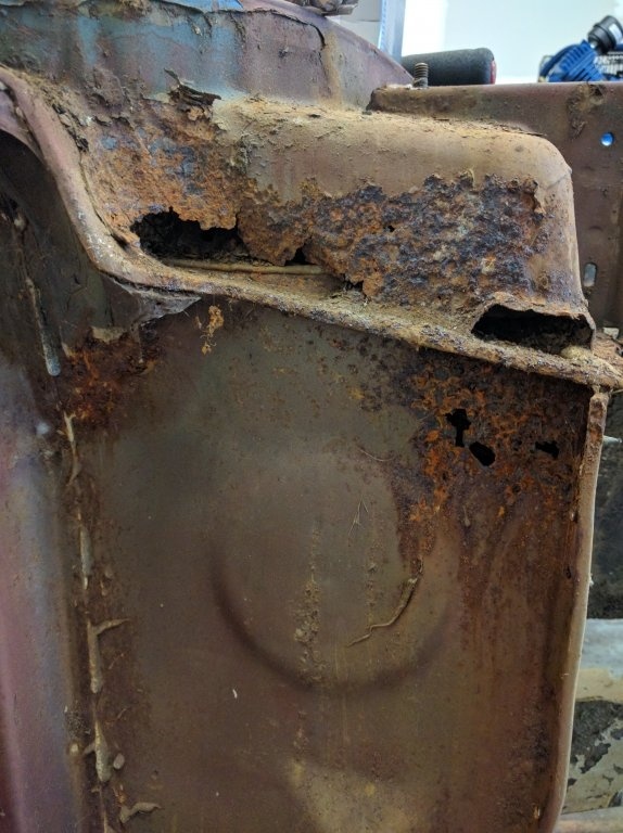

Does anybody know what the piece behind the silver headlight buckets is called? The drivers side has rusted through on a few of the tabs that bolt it to the fender. If anyone has any leads on one, that would be greatly appreciated.
I tried to remove the torsion bars, but they wouldn't budge - cut them in half instead. Removed the top nut holding the shock to the shock tower and unbolted the upper control arms. That just left a couple brake lines and the K-member bolts holding the entire front suspension in. Pulled everything out as one unit and then stripped the K-member.

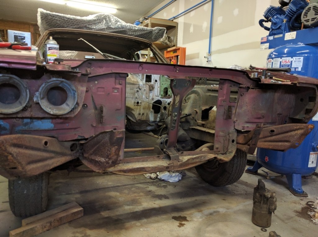

Next, the front fenders came off and it's starting to look like less of a car. The hidden rust and needed repairs are starting to come into focus.

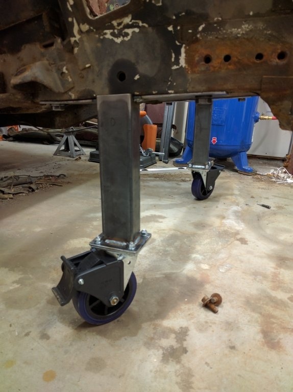

I wanted to be able to move the car around - I don't have the widest garage to work in. So I bought some casters with 8" wheels and some box steel. Fabricated a plate to bolt to the K-member mounting holes on the frame and then welded 2" x 3" rectangle box to the plate and then to a small plate on the other end that bolts to the caster.
I then welded a cross brace in between that isn't pictured. I learned later that the width is too narrow and i'll have to make some modifications in the future.
I also made some caster mounts for the rear that bolt to the front leaf spring hangar location

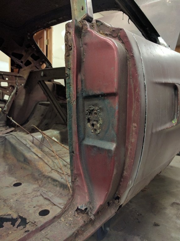

I then removed the drivers quarter panel - although there wasn't much holding it on except for spot welds/lead at the roof

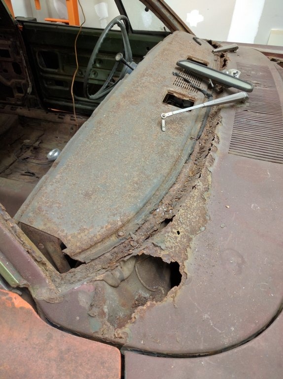

The outer cowl shell is rusted through on the ends where leaves accumulated and water couldn't drain - I will get some better pictures this weekend but here is what it looked like before blasting
The flange that the bottom of the windshield seals to is gone - I haven't ordered a new outer cowl panel from AMD yet, I think the inner cowl panel is okay but won't know for sure until I pull that outer panel.
